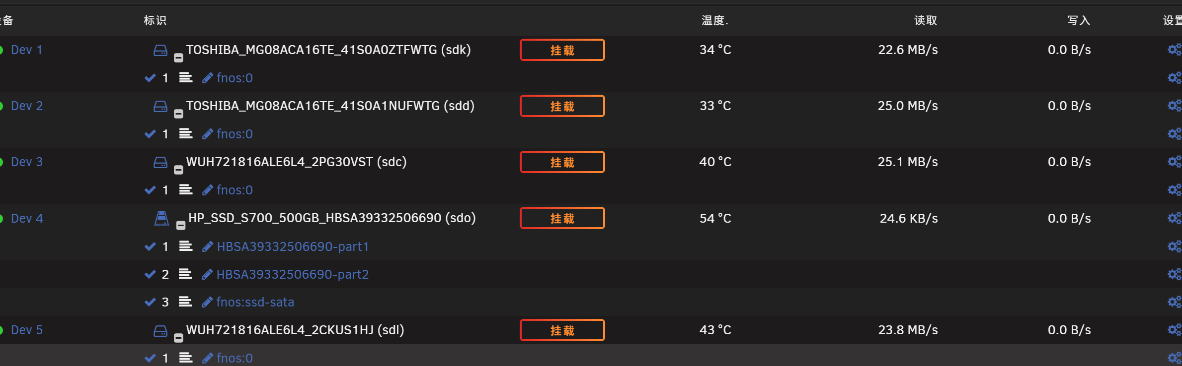

unraid虚拟机,通过挂载/dev的方式直通了4块硬盘

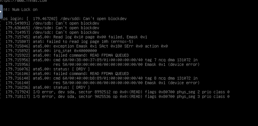

2025-5-21 15:07:22 楼主 显示全部楼层
用reboot重启了一下,发现除了ata5,ata6-ata8都有类似的报错
好像图片传不上来。。
fnos login:[168.240002] ata6.00: Read 1og 0x10 page 0x00 failed, Emask 0x1
168.240107]ata6: failed to read log page 10h (errno=-5)
168.240150]ata6.00: exception Emask 0x1 SAct 0x100000 SErr 0x0 action 0x0
168.240200]ata6.00:irq_stat 0x40000000
168.240234]ata6.00: failed command: READ FPDMA QUEUED
168.240294]ata6.00: cmd 60/20:a0:80:b0:90/00:00:71:00:00/40 tag 20 ncq dma 16384 in
168.240294]res 50/00:00:00:00:00/00:00:00:00:00/00 Emask 0x1 (device error)
168.240401]ata6.00: status: { DRDY }
168.895712]ata5.00: Read log 0x10 page 0x00 failed, Emask 0x1
168.895759]ata5: failed to read log page 10h (errno=-5)
168.895783]ata5.00: exception Emask 0x1 SAct 0x600000 SErr 0x0 action 0x0
168.895810]ata5.00: irq_stat 0x40000000
168.895828]ata5.00: failed command: READ FPDMA QUEUED
168.895847]ata5.00: cmd 60/00:a8:00:27:89/01:00:00:00:00/40 tag 21 ncq dma 131072 in
168.895847]res 50/04:00:00:00:00/00:00:00:00:00/00 Emask 0x1 (device error)
168.895904]ata5.O0:status:{ DRDY}
168.895920]ata5.00: error: ABRT }
168.895936]ata5.OO: failed command: READ FPDMA QUEUED
168.895955]ata5.00: cmd 60/00:b0:00:28:89/01:00:00:00:00/40 tag 22 ncq dma 131072 in
168.895955]res 50/04:00:00:00:00/00:00:00:00:00/00 Emask 0x1 (device err0r)
168.896009]ata5.O0: status: DRDY}
168.896024]ata5.00: error: { ABRT 3
168.897492]I/0 error, dev sda, sector 8988416 op 0x0:(READ) flags 0x80700 phys_seg 2 prio class 0
168.89757811/0 error,dev sda, sector 8988672 op 0x0:(READ) flags 0x80700 phys_seg 2 pri0 class 0
168.940419]/dev/sdd: Can't open blockdev
168.992091]/dev/sdb: Can't open blockdev
169.042707]/dev/sde: Can't open blockdev
169.092185]/dev/sdc: Can't open blockdev
170.059811]ata7.00: Read 1og 0x10 page 0x00 failed, Emask 0x1
170.059884]ata7: failed to read log page 10h (errno=-5)
170.061093]ata7.00: exception Emask 0x1 SAct 0x800 SErr 0x0 action 0x0
170.062245]ata7.00: irq_stat 0x40000000
170.063469]ata7.OO: failed command: READ FPDMA QUEUED
170.064681]ata7.00: cmd 60/08:58:80:08:00/00:00:00:00:00/40 tag 11 ncq dma 4096 in
170.064681]res 50/04:00:00:00:00/00:00:00:00:00/00 Emask 0x1 (device error)
170.066061]ata7.00:status:{ DRDY}
170.066721]ata7.00:error:{ABRT}
170.071869]I/0 error, dev sde, sector 2176 op 0x0:(READ) flags 0x80700 phys_seg 1 prio class 0
170.080195] ata8: i1legal qc_active transition (00000000->00800000)

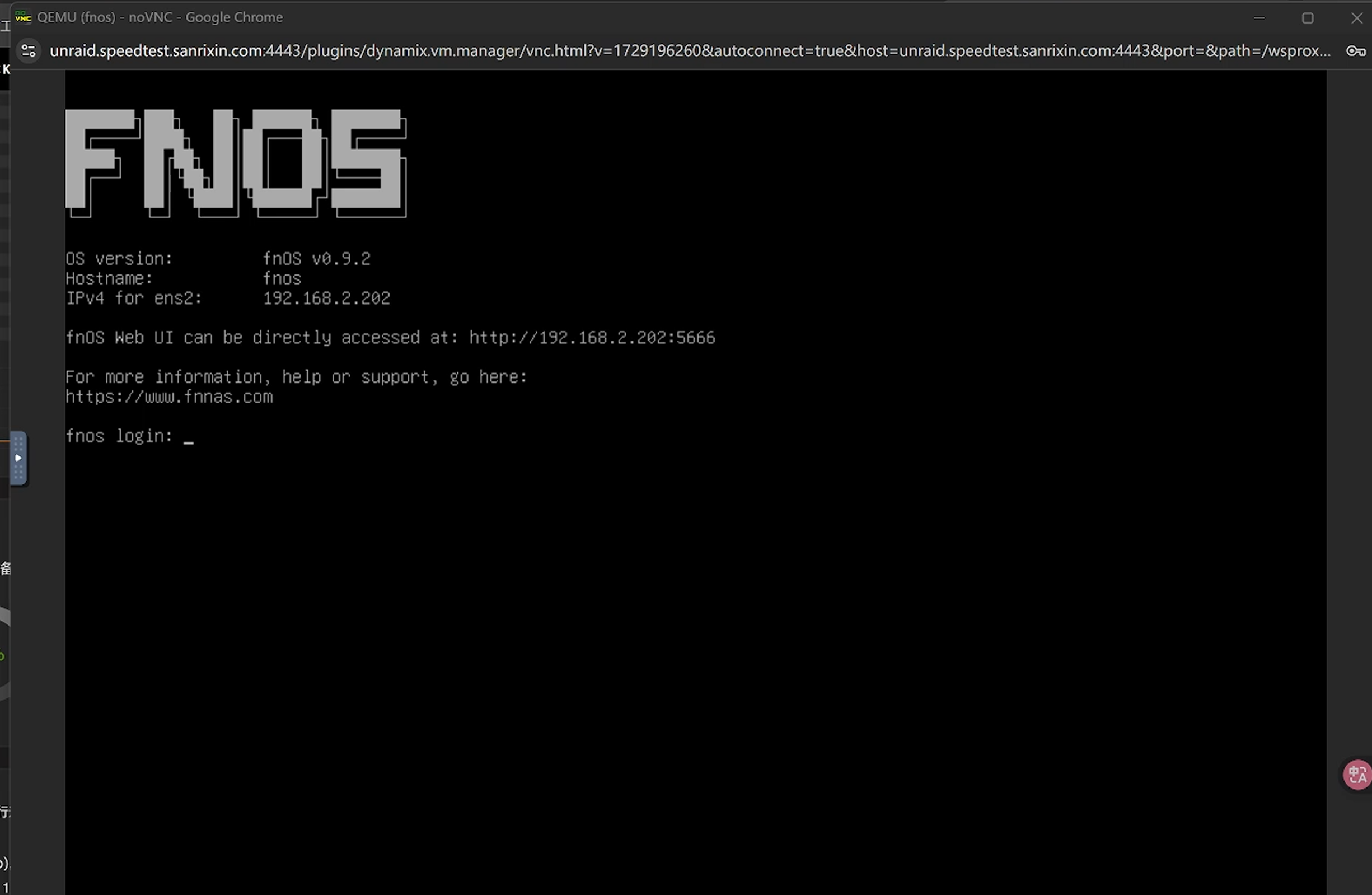

大佬再看看呢,还是换数据线吗
你现在飞牛的屏幕截个图看看。

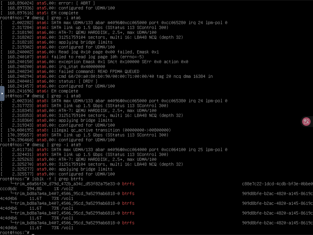

2025-5-21 17:03:34 楼主 显示全部楼层
一开始是这样的,我用sudo -i,运行了 dmesg | grep -i atalsblk -f | grep btrfs,然后VNC动不了,现在失去控制了。
