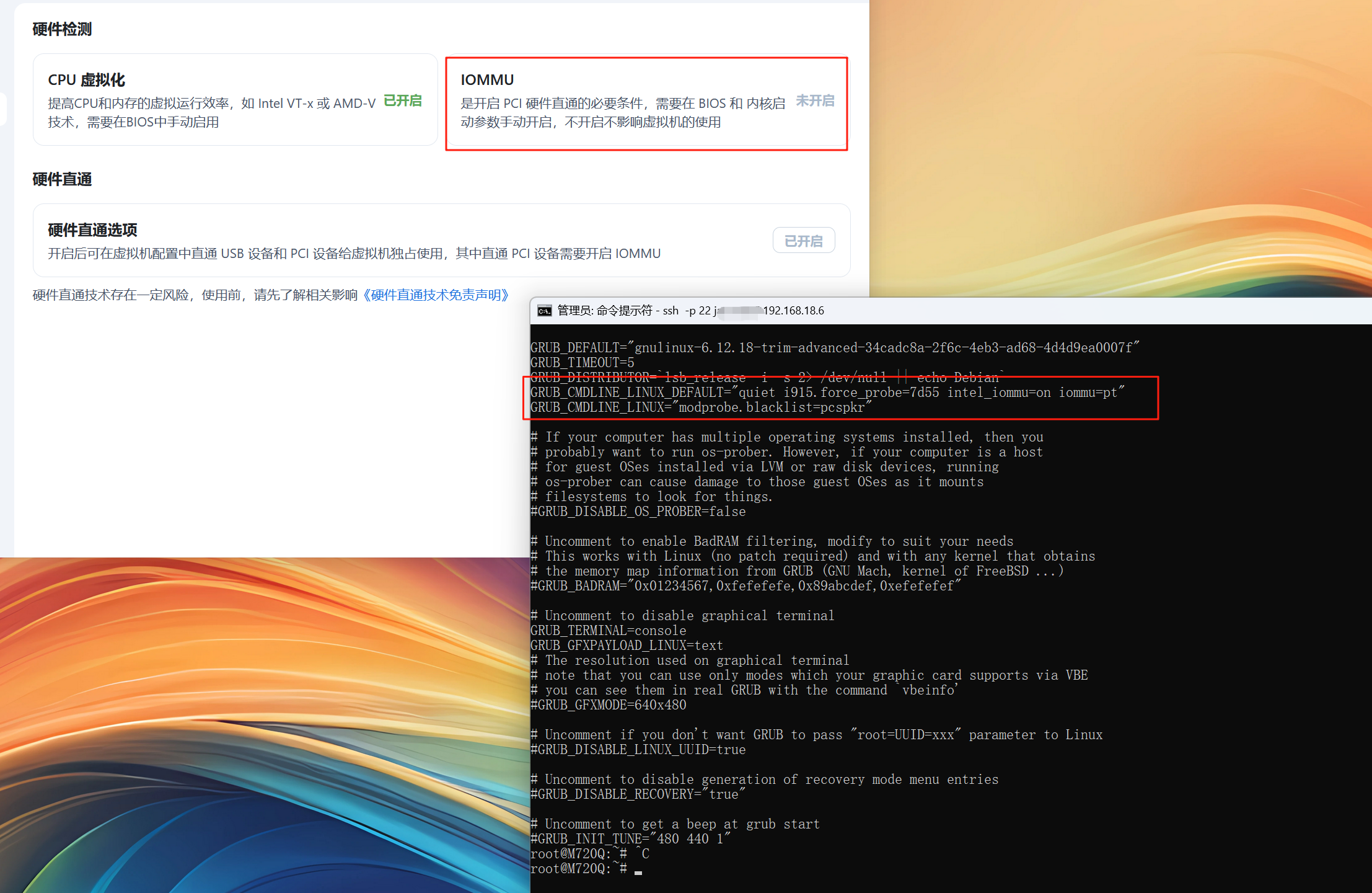

2025-7-31 09:03:23 显示全部楼层 阅读模式
GRUB_CMDLINE_LINUX_DEFAULT="quiet i915.force_probe=7d55 intel_iommu=on iommu=pt"
已经配置https://club.fnnas.com/forum.php?mod=viewthread&tid=20974
重启不行还是没显示。
是联想的M720q cpu 是9500t很奇怪。

2025-7-31 12:48:05 显示全部楼层
信息给的不全,你有update-grub吗?

2025-7-31 19:32:09 楼主 显示全部楼层
# If you change this file, run 'update-grub' afterwards to update
# /boot/grub/grub.cfg.
# For full documentation of the options in this file, see:
#   info -f grub -n 'Simple configuration'
GRUB_DEFAULT="gnulinux-6.12.18-trim-advanced-34cadc8a-2f6c-4eb3-ad68-4d4d9ea0007f"
GRUB_TIMEOUT=5
GRUB_DISTRIBUTOR=`lsb_release -i -s 2> /dev/null || echo Debian`
GRUB_CMDLINE_LINUX="modprobe.blacklist=pcspkr"

2025-7-31 19:35:42 楼主 显示全部楼层
root@M720Q:~# cat /proc/cmdline
BOOT_IMAGE=/boot/vmlinuz-6.12.18-trim root=UUID=34cadc8a-2f6c-4eb3-ad68-4d4d9ea0007f ro modprobe.blacklist=pcspkr quiet i915.force_probe=7d55 intel_iommu=on iommu=pt
root@M720Q:~# dmesg | grep -i iommu
[    0.000000] Command line: BOOT_IMAGE=/boot/vmlinuz-6.12.18-trim root=UUID=34cadc8a-2f6c-4eb3-ad68-4d4d9ea0007f ro modprobe.blacklist=pcspkr quiet i915.force_probe=7d55 intel_iommu=on iommu=pt
[    0.025127] Kernel command line: BOOT_IMAGE=/boot/vmlinuz-6.12.18-trim root=UUID=34cadc8a-2f6c-4eb3-ad68-4d4d9ea0007f ro modprobe.blacklist=pcspkr quiet i915.force_probe=7d55 intel_iommu=on iommu=pt
[    0.025229] DMAR: IOMMU enabled
[    0.373084] iommu: Default domain type: Passthrough (set via kernel command line)
root@M720Q:~#
命令行看起来可以但是网页不是
6220
2025-7-31 19:37:16 显示全部楼层
BOOT_IMAGE=/boot/vmlinuz-6.12.18-trim root=UUID=34cadc8a-2f6c-4eb3 ...
BIOS设置里关于虚拟化的都开启。

2025-7-31 19:58:28 楼主 显示全部楼层
lspci -nn | grep -iE "vga|3d|display"
00:02.0 VGA compatible controller [0300]: Intel Corporation CoffeeLake-S GT2 [UHD Graphics 630] [8086:3e92]
00:1c.0 PCI bridge [0604]: Intel Corporation Cannon Lake PCH PCI Express Root Port #6 [8086:a33d] (rev f0)
root@M720Q:~# # 查看当前内核启动参数
cat /proc/cmdline
BOOT_IMAGE=/boot/vmlinuz-6.12.18-trim root=UUID=34cadc8a-2f6c-4eb3-ad68-4d4d9ea0007f ro modprobe.blacklist=pcspkr quiet i915.force_probe=3e92 intel_iommu=on iommu=pt
[    0.000000] Command line: BOOT_IMAGE=/boot/vmlinuz-6.12.18-trim root=UUID=34cadc8a-2f6c-4eb3-ad68-4d4d9ea0007f ro modprobe.blacklist=pcspkr quiet i915.force_probe=3e92 intel_iommu=on iommu=pt
[    0.025159] Kernel command line: BOOT_IMAGE=/boot/vmlinuz-6.12.18-trim root=UUID=34cadc8a-2f6c-4eb3-ad68-4d4d9ea0007f ro modprobe.blacklist=pcspkr quiet i915.force_probe=3e92 intel_iommu=on iommu=pt
[    0.025262] DMAR: IOMMU enabled
[    0.368955] iommu: Default domain type: Passthrough (set via kernel command line)
root@M720Q:~#
6220
2025-7-31 20:24:54 显示全部楼层
00:02.0 VGA compatible controller [0300]: Intel Corporation  ...
按照你提供的信息看,没问题啊,去BIOS里把关于虚拟化的设置都关闭再开启一遍,测试一下。
还真的是bios少开了一个选项,之前记得安装开过,估计遗漏了。之前安装pve的的时候。可以了  详情 回复

2025-8-5 10:54:30 楼主 显示全部楼层
玉尺书生 发表于 2025-7-31 20:24
按照你提供的信息看,没问题啊,去BIOS里把关于虚拟化的设置都关闭再开启一遍,测试一下。 ...
