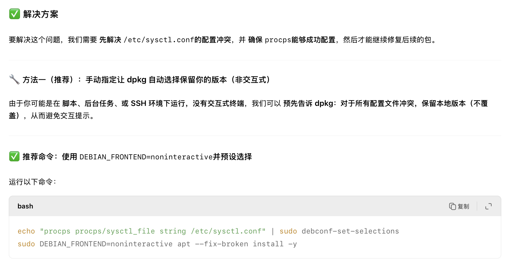

将终端报错信息复制给腾讯元宝
Configuration file '/etc/sysctl.conf'
 ==> File on system created by you or by a script.
 ==> File also in package provided by package maintainer.
   What would you like to do about it ?  Your options are:
    Y or I  : install the package maintainer's version
    N or O  : keep your currently-installed version
      D     : show the differences between the versions
      Z     : start a shell to examine the situation
 The default action is to keep your current version.
*** sysctl.conf (Y/I/N/O/D/Z) [default=N] ? dpkg: error processing package procps (--configure):
 end of file on stdin at conffile prompt
Setting up dbus-system-bus-common (1.14.10-1~deb12u1) ...
Setting up libpam-runtime (1.5.2-6+deb12u1) ...
Setting up dbus-bin (1.14.10-1~deb12u1) ...
dpkg: dependency problems prevent configuration of dconf-service:
 dconf-service depends on procps; however:
  Package procps is not configured yet.
dpkg: error processing package dconf-service (--configure):
 dependency problems - leaving unconfigured
Setting up dbus-daemon (1.14.10-1~deb12u1) ...
Setting up dbus (1.14.10-1~deb12u1) ...
dbus.service is a disabled or a static unit, not starting it.
Setting up libpam-systemd:amd64 (252.38-1~deb12u1) ...
Setting up dbus-user-session (1.14.10-1~deb12u1) ...
Errors were encountered while processing:
 procps
 dconf-service
E: Sub-process /usr/bin/dpkg returned an error code (1)
按照AI给出的答案,尽量选择推荐的方式来处理

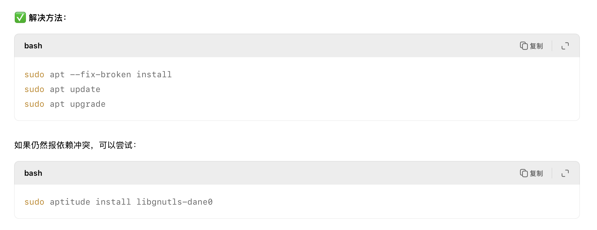

我还遇到一个情况是因为我的系统中没有安装这个组件,AI会提示
这种情况就执行
sudo apt --fix-broken install
然后再尝试更新系统,如果还是报错,就执行
sudo aptitude install libgnutls-dane0
aptitude是系统的一个工具,如果没有安装,需要先安装
sudo apt install aptitude
