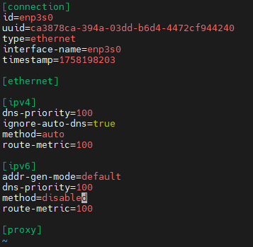

没错是这个配置文件,
  GNU nano 7.2                                                             Wired connection 2.nmconnection
[connection]
id=Wired connection 2
uuid=37f1fd44-476a-3fe7-9367-8acc29f5dbc7
type=ethernet
autoconnect-priority=-999
interface-name=enp3s0
timestamp=1758814113
[ethernet]
[ipv4]
address1=172.16.1.6/8,172.16.1.254
dns=172.16.1.254;
method=manual
route-metric=100
[ipv6]
addr-gen-mode=default
method=disabled
route-metric=100
[proxy]
这参数怎么改成默认关闭呢?
默认是这样的  详情 回复
2025-9-26 10:09

2025-9-26 10:09:51 显示全部楼层
[quote][size=2][url=forum.php?mod=redirect&goto=findpost&pid=179307&ptid=38484][color=#999999]将进酒杯莫 发表于 2025-9-25 23:41[/color][/url][/size] 没错是这个配置文件, GNU nano 7.2 Wi ...[/quote]
默认是这样的
