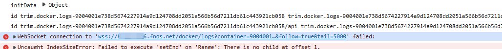

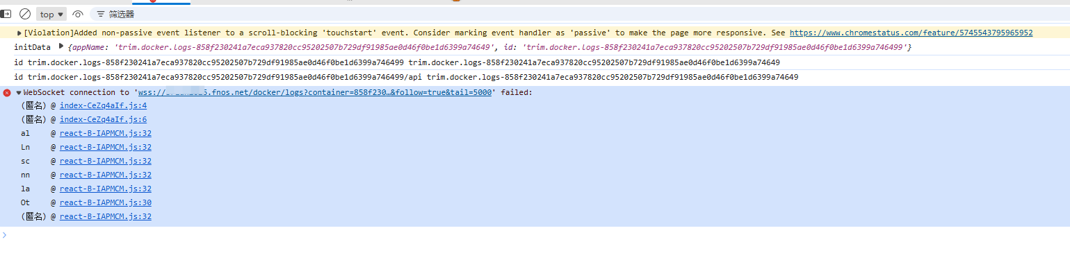

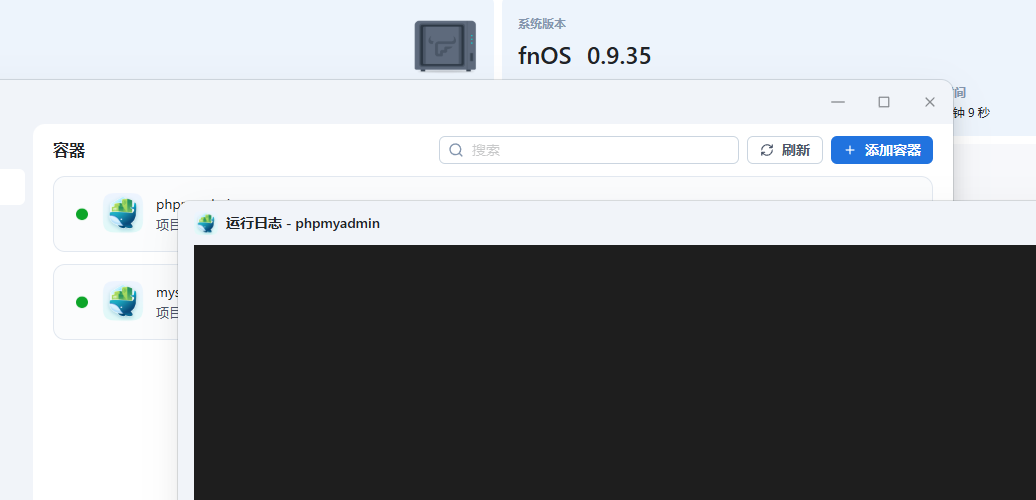

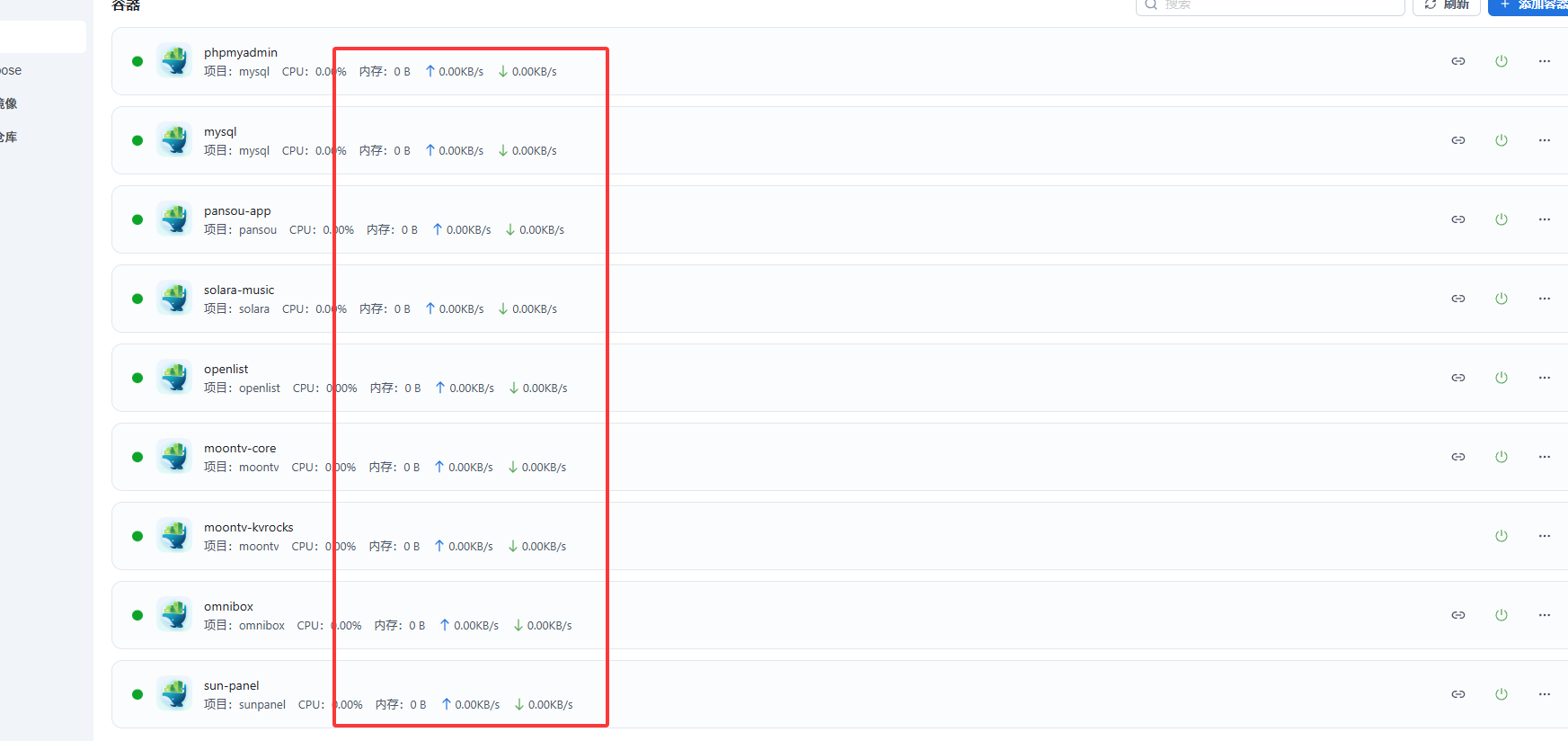

问题描述:
设备环境:(物理机/虚拟机都是这样,系统版本0.9.35)
BUG现象:(docker运行时,不显示日志,使用ssh查看是有日志产生的,1panel查看日志正常,容器中日志文件正常)
联系方式:(微信629群:brian_docker)
日志文件:(https://share.fnnas.net/s/a14601296d264cf299)
F12报接口failed.

不显示日志的系统查询dsmgr:
systemctl status dsmgr
● dsmgr.service - trim docker stream service
Loaded: loaded (/etc/systemd/system/dsmgr.service; enabled; preset: enabled)
Active: active (running) since Mon 2025-11-17 11:10:40 CST; 3h 45min ago
Main PID: 8029 (dsmgr)
Tasks: 8 (limit: 4053)
Memory: 13.6M
CPU: 8.822s
CGroup: /system.slice/dsmgr.service
**─8029 /usr/trim/bin/dsmgr
Nov 17 14:55:56 BrianNas dsmgr[8029]: [Stats]Close the channel, err:Error response from daemon: client version 1.24 is too old. Minimum supported API version is 1.44, please upgrade your client to a newer version
Nov 17 14:55:56 BrianNas dsmgr[8029]: time="2025-11-17T14:55:56+08:00" level=error msg="runStats err:Error response from daemon: **client version 1.24 is too old. Minimum supported API version is 1.44**, please upgrade your cli>
Nov 17 14:56:06 BrianNas dsmgr[8029]: [Stats]Close the channel, err:Error response from daemon: client version 1.24 is too old. Minimum supported API version is 1.44, please upgrade your client to a newer version
Nov 17 14:56:06 BrianNas dsmgr[8029]: time="2025-11-17T14:56:06+08:00" level=error msg="runStats err:Error response from daemon: client version 1.24 is too old. Minimum supported API version is 1.44, please upgrade your cli>
Nov 17 14:56:16 BrianNas dsmgr[8029]: [Stats]Close the channel, err:Error response from daemon: client version 1.24 is too old. Minimum supported API version is 1.44, please upgrade your client to a newer version
Nov 17 14:56:16 BrianNas dsmgr[8029]: time="2025-11-17T14:56:16+08:00" level=error msg="runStats err:Error response from daemon: client version 1.24 is too old. Minimum supported API version is 1.44, please upgrade your cli>
Nov 17 14:56:26 BrianNas dsmgr[8029]: [Stats]Close the channel, err:Error response from daemon: client version 1.24 is too old. Minimum supported API version is 1.44, please upgrade your client to a newer version
Nov 17 14:56:26 BrianNas dsmgr[8029]: time="2025-11-17T14:56:26+08:00" level=error msg="runStats err:Error response from daemon: client version 1.24 is too old. Minimum supported API version is 1.44, please upgrade your cli>
Nov 17 14:56:36 BrianNas dsmgr[8029]: [Stats]Close the channel, err:Error response from daemon: client version 1.24 is too old. Minimum supported API version is 1.44, please upgrade your client to a newer version
Nov 17 14:56:36 BrianNas dsmgr[8029]: time="2025-11-17T14:56:36+08:00" level=error msg="runStats err:Error response from daemon: client version 1.24 is too old. Minimum supported API version is 1.44, please upgrade your cli>
