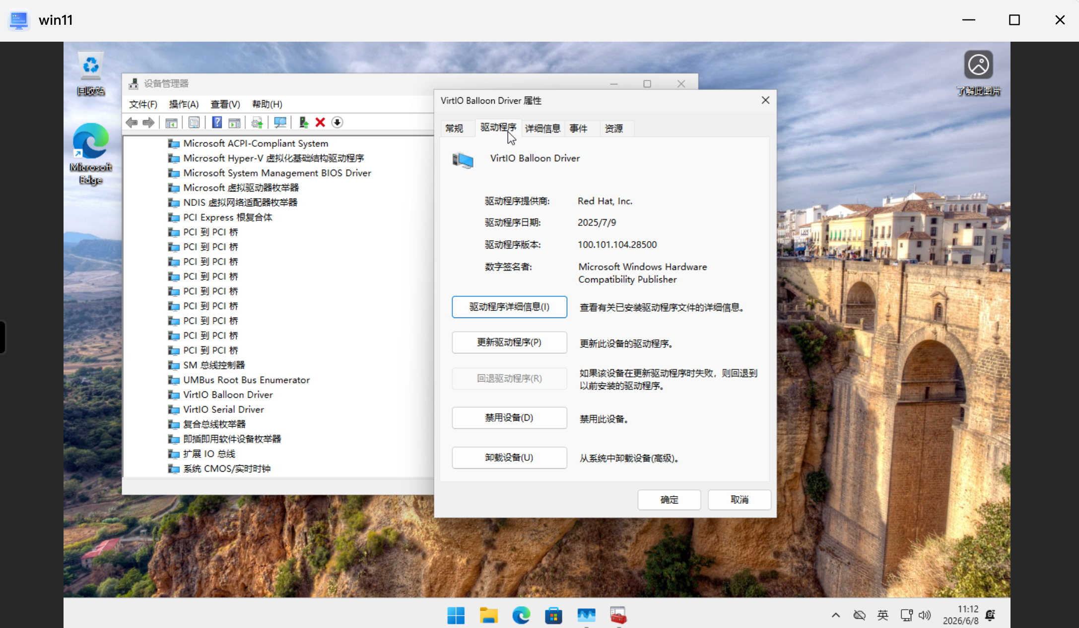

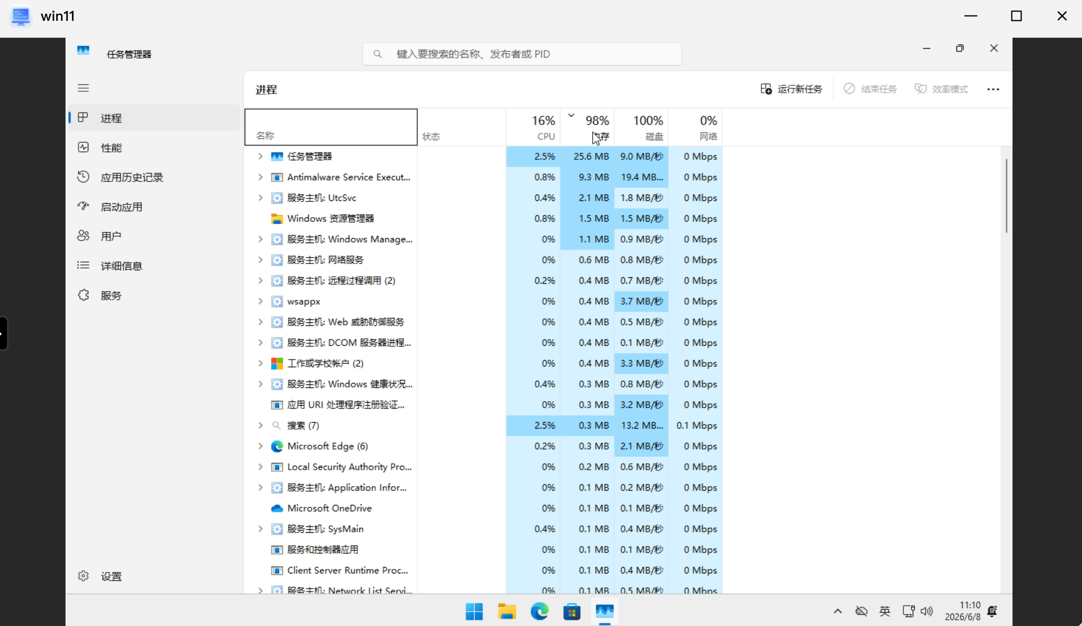

2026-6-8 11:13:17 显示全部楼层
您好,我想请教一下,我跟着您的教程操作,操作完成之后发现宿主机的内存占用并没有下降,而且虚拟机内部的内存占用还直接变成占满了,请问这个是什么情况,应该如何解决
下面是我的相关操作和状态情况:
`bash
root@fnNAS:~# virsh setmaxmem gm2qv8zi 8388608 --config
root@fnNAS:~# virsh dumpxml gm2qv8zi | grep 8388608
  <memory unit='KiB'>8388608</memory>
root@fnNAS:~# virsh setmem gm2qv8zi 1048576 --config
root@fnNAS:~# virsh dumpxml gm2qv8zi | grep 1048576
  <currentMemory unit='KiB'>1048576</currentMemory>
root@fnNAS:~# virsh start gm2qv8zi
Domain 'gm2qv8zi' started
root@fnNAS:~# virsh domstats gm2qv8zi --balloon
Domain: 'gm2qv8zi'
  balloon.current=8388608
  balloon.maximum=8388608
  balloon.last-update=0
  balloon.rss=8446724
Domain: 'gm2qv8zi'
  balloon.current=1157120
  balloon.swap_in=1887872
  balloon.swap_out=310156
  balloon.major_fault=67795
  balloon.minor_fault=1601990
  balloon.unused=54068
  balloon.available=8383516
  balloon.usable=55174
  balloon.last-update=1780887649
  balloon.disk_caches=2212
  balloon.hugetlb_pgalloc=0
  balloon.hugetlb_pgfail=0
  balloon.rss=8458200
root@fnNAS:~# htop
root@fnNAS:~# free -h
               total        used        free      shared  buff/cache   available
Mem:            15Gi        11Gi       576Mi       143Mi       3.4Gi       3.5Gi
Swap:          4.0Gi       2.0Gi       2.0Gi
虚拟机内部的内存莫名其妙占满:
虚拟机内部的驱动安装正常:
驱动版本信息:
