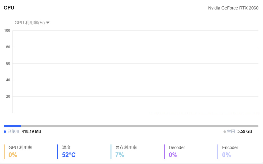

1.1.3104 系统,580 驱动装上了。
但是 ffmpeg 调用显卡进行转码时报错:
ffmpeg -f lavfi -i testsrc -c:v h264_nvenc -t 1 -f null -
ffmpeg version 7.1.3-mediasrv Copyright (c) 2000-2025 the FFmpeg developers
  built with gcc 12 (Debian 12.2.0-14+deb12u1)
  configuration: --prefix=/usr/trim/lib/mediasrv --target-os=linux --extra-version=mediasrv --disable-doc --disable-ffplay --disable-static --disable-libxcb --disable-sdl2 --disable-xlib --enable-lto=auto --enable-gpl --enable-version3 --enable-shared --enable-gmp --enable-gnutls --enable-chromaprint --enable-opencl --enable-libdrm --enable-libxml2 --enable-libass --enable-libfreetype --enable-libfribidi --enable-libfontconfig --enable-libharfbuzz --enable-libbluray --enable-libmp3lame --enable-libopus --enable-libtheora --enable-libvorbis --enable-libopenmpt --enable-libdav1d --enable-libsvtav1 --enable-libwebp --enable-libvpx --enable-libx264 --enable-libx265 --enable-libzvbi --enable-libzimg --enable-libfdk-aac --arch=amd64 --enable-libshaderc --enable-libplacebo --enable-vulkan --enable-vaapi --enable-amf --enable-libvpl --enable-ffnvcodec --enable-cuda --enable-cuda-llvm --enable-cuvid --enable-nvdec --enable-nvenc
  libavutil      59. 39.100 / 59. 39.100
  libavcodec     61. 19.101 / 61. 19.101
  libavformat    61.  7.100 / 61.  7.100
  libavdevice    61.  3.100 / 61.  3.100
  libavfilter    10.  4.100 / 10.  4.100
  libswscale      8.  3.100 /  8.  3.100
  libswresample   5.  3.100 /  5.  3.100
  libpostproc    58.  3.100 / 58.  3.100
Input #0, lavfi, from 'testsrc':
  Duration: N/A, start: 0.000000, bitrate: N/A
  Stream #0:0: Video: wrapped_avframe, rgb24, 320x240 [SAR 1:1 DAR 4:3], 25 fps, 25 tbr, 25 tbn
Stream mapping:
  Stream #0:0 -> #0:0 (wrapped_avframe (native) -> h264 (h264_nvenc))
Press [q] to stop, [?] for help
[h264_nvenc @ 0x55ce803ee980] dl_fn->cuda_dl->cuInit(0) failed -> CUDA_ERROR_UNKNOWN: unknown error
[vost#0:0/h264_nvenc @ 0x55ce803ee4c0] Error while opening encoder - maybe incorrect parameters such as bit_rate, rate, width or height.
[vf#0:0 @ 0x55ce8040b340] Error sending frames to consumers: Unknown error occurred
[vf#0:0 @ 0x55ce8040b340] Task finished with error code: -1313558101 (Unknown error occurred)
[vf#0:0 @ 0x55ce8040b340] Terminating thread with return code -1313558101 (Unknown error occurred)
[vost#0:0/h264_nvenc @ 0x55ce803ee4c0] Could not open encoder before EOF
[vost#0:0/h264_nvenc @ 0x55ce803ee4c0] Task finished with error code: -22 (Invalid argument)
[vost#0:0/h264_nvenc @ 0x55ce803ee4c0] Terminating thread with return code -22 (Invalid argument)
[out#0/null @ 0x55ce803ed9c0] Nothing was written into output file, because at least one of its streams received no packets.
frame=    0 fps=0.0 q=0.0 Lsize=       0KiB time=N/A bitrate=N/A speed=N/A
Conversion failed!

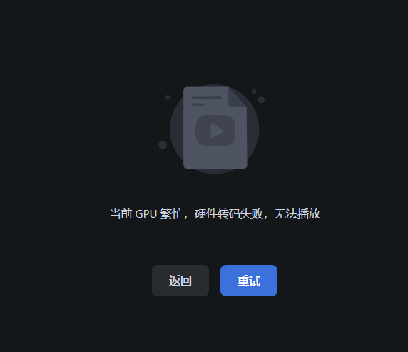

2026-5-19 23:12:40 楼主 显示全部楼层
飞牛官方影视应用也无法转码
