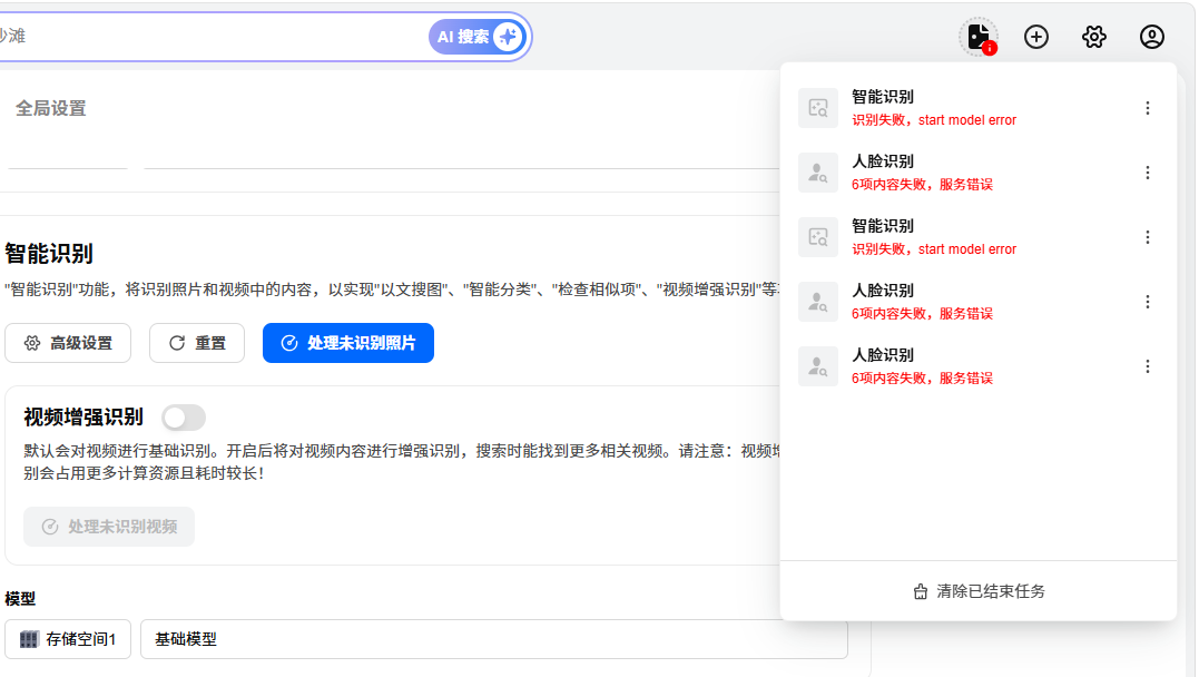

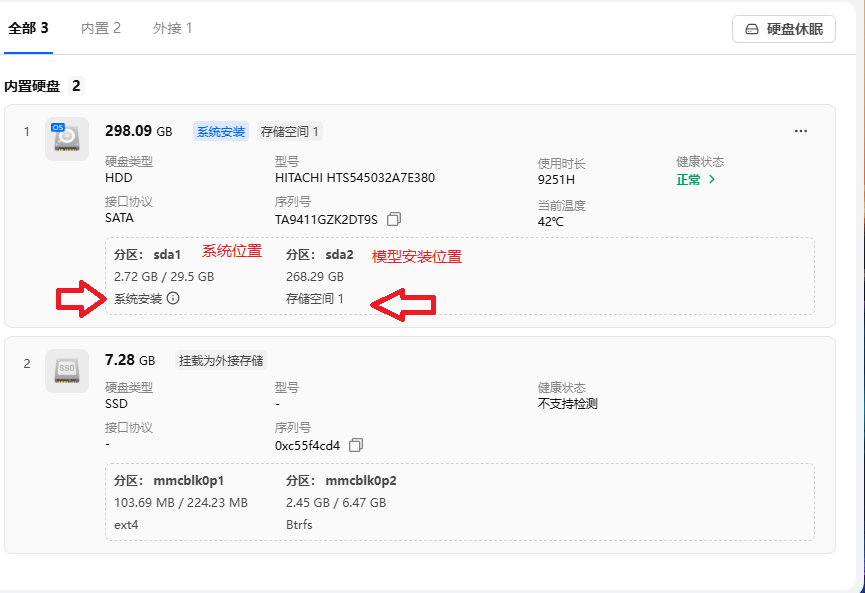

我的设备是某RK3566 T ,首次安装飞牛在内置的emmc里面,AI模型是可以正常使用的。后来重新刷系统,并且把系统迁移到机械硬盘之后,这个ai模型就不能用了。无论我怎么重新安装系统,多次卸载模型再重新安装模型,都是不行,有人遇到过这个问题吗?
日志我导出来了
time="2026-04-04T22:38:02+08:00" level=error msg="key:1 index is not exist"
time="2026-04-04T22:58:11+08:00" level=error msg="CallFaceDet dest:/vol1/1000/Photos/MobileBackup/Xiaomi 24129PN74C/DCIM/2023/8/IMG_20230817_220035IDPHOTO.jpg confidence:0.65 error:start model error"
time="2026-04-04T22:58:11+08:00" level=error msg="detFaceByUserPhotoId filePath:/vol1/1000/Photos/MobileBackup/Xiaomi 24129PN74C/DCIM/2023/8/IMG_20230817_220035IDPHOTO.jpg error: start model error code: 20705 msg: start model error"
time="2026-04-04T22:58:11+08:00" level=error msg="AddError error: start model error code: 20705 msg: start model error"
time="2026-04-04T22:58:12+08:00" level=error msg="CallFaceDet dest:/vol1/1000/Photos/PhotoLibrary/2015/7/20150709_135514000_iOS.jpg confidence:0.65 error:start model error"
time="2026-04-04T22:58:12+08:00" level=error msg="detFaceByUserPhotoId filePath:/vol1/1000/Photos/PhotoLibrary/2015/7/20150709_135514000_iOS.jpg error: start model error code: 20705 msg: start model error"
time="2026-04-04T22:58:12+08:00" level=error msg="AddError error: start model error code: 20705 msg: start model error"
time="2026-04-04T22:58:13+08:00" level=error msg="CallFaceDet dest:/vol1/1000/Photos/PhotoLibrary/2015/7/20150710_092948000_iOS.jpg confidence:0.65 error:start model error"
time="2026-04-04T22:58:13+08:00" level=error msg="detFaceByUserPhotoId filePath:/vol1/1000/Photos/PhotoLibrary/2015/7/20150710_092948000_iOS.jpg error: start model error code: 20705 msg: start model error"
time="2026-04-04T22:58:13+08:00" level=error msg="AddError error: start model error code: 20705 msg: start model error"
time="2026-04-04T22:58:13+08:00" level=error msg="CallFaceDet dest:/vol1/1000/Photos/PhotoLibrary/2015/7/20150710_092953000_iOS.jpg confidence:0.65 error:start model error"
time="2026-04-04T22:58:13+08:00" level=error msg="detFaceByUserPhotoId filePath:/vol1/1000/Photos/PhotoLibrary/2015/7/20150710_092953000_iOS.jpg error: start model error code: 20705 msg: start model error"
time="2026-04-04T22:58:14+08:00" level=error msg="CallFaceDet dest:/vol1/1000/Photos/PhotoLibrary/2015/7/20150710_093001000_iOS.jpg confidence:0.65 error:start model error"
time="2026-04-04T22:58:14+08:00" level=error msg="detFaceByUserPhotoId filePath:/vol1/1000/Photos/PhotoLibrary/2015/7/20150710_093001000_iOS.jpg error: start model error code: 20705 msg: start model error"
time="2026-04-04T22:58:14+08:00" level=error msg="AddError error: start model error code: 20705 msg: start model error"
time="2026-04-04T22:58:15+08:00" level=error msg="CallFaceDet dest:/vol1/1000/Photos/PhotoLibrary/2015/7/20150710_093013000_iOS.jpg confidence:0.65 error:start model error"
time="2026-04-04T22:58:15+08:00" level=error msg="detFaceByUserPhotoId filePath:/vol1/1000/Photos/PhotoLibrary/2015/7/20150710_093013000_iOS.jpg error: start model error code: 20705 msg: start model error"
time="2026-04-04T22:58:15+08:00" level=error msg="AddError error: start model error code: 20705 msg: start model error"
time="2026-04-04T23:53:47+08:00" level=error msg="CallFaceDet dest:/vol1/1000/Photos/MobileBackup/Xiaomi 24129PN74C/DCIM/2023/8/IMG_20230817_220035IDPHOTO.jpg confidence:0.65 error:start model error"
time="2026-04-04T23:53:47+08:00" level=error msg="detFaceByUserPhotoId filePath:/vol1/1000/Photos/MobileBackup/Xiaomi 24129PN74C/DCIM/2023/8/IMG_20230817_220035IDPHOTO.jpg error: start model error code: 20705 msg: start model error"
time="2026-04-04T23:53:47+08:00" level=error msg="AddError error: start model error code: 20705 msg: start model error"
time="2026-04-04T23:53:47+08:00" level=error msg="CallFaceDet dest:/vol1/1000/Photos/PhotoLibrary/2015/7/20150709_135514000_iOS.jpg confidence:0.65 error:start model error"
time="2026-04-04T23:53:47+08:00" level=error msg="detFaceByUserPhotoId filePath:/vol1/1000/Photos/PhotoLibrary/2015/7/20150709_135514000_iOS.jpg error: start model error code: 20705 msg: start model error"
time="2026-04-04T23:53:48+08:00" level=error msg="CallFaceDet dest:/vol1/1000/Photos/PhotoLibrary/2015/7/20150710_092948000_iOS.jpg confidence:0.65 error:start model error"
time="2026-04-04T23:53:48+08:00" level=error msg="detFaceByUserPhotoId filePath:/vol1/1000/Photos/PhotoLibrary/2015/7/20150710_092948000_iOS.jpg error: start model error code: 20705 msg: start model error"
time="2026-04-04T23:53:48+08:00" level=error msg="AddError error: start model error code: 20705 msg: start model error"
time="2026-04-04T23:53:48+08:00" level=error msg="CallFaceDet dest:/vol1/1000/Photos/PhotoLibrary/2015/7/20150710_092953000_iOS.jpg confidence:0.65 error:start model error"
time="2026-04-04T23:53:48+08:00" level=error msg="detFaceByUserPhotoId filePath:/vol1/1000/Photos/PhotoLibrary/2015/7/20150710_092953000_iOS.jpg error: start model error code: 20705 msg: start model error"
time="2026-04-04T23:53:49+08:00" level=error msg="CallFaceDet dest:/vol1/1000/Photos/PhotoLibrary/2015/7/20150710_093001000_iOS.jpg confidence:0.65 error:start model error"
time="2026-04-04T23:53:49+08:00" level=error msg="detFaceByUserPhotoId filePath:/vol1/1000/Photos/PhotoLibrary/2015/7/20150710_093001000_iOS.jpg error: start model error code: 20705 msg: start model error"
time="2026-04-04T23:53:49+08:00" level=error msg="AddError error: start model error code: 20705 msg: start model error"
time="2026-04-04T23:53:49+08:00" level=error msg="CallFaceDet dest:/vol1/1000/Photos/PhotoLibrary/2015/7/20150710_093013000_iOS.jpg confidence:0.65 error:start model error"
time="2026-04-04T23:53:49+08:00" level=error msg="detFaceByUserPhotoId filePath:/vol1/1000/Photos/PhotoLibrary/2015/7/20150710_093013000_iOS.jpg error: start model error code: 20705 msg: start model error"
time="2026-04-04T23:54:35+08:00" level=error msg="CallFaceDet dest:/vol1/1000/Photos/MobileBackup/Xiaomi 24129PN74C/DCIM/2023/8/IMG_20230817_220035IDPHOTO.jpg confidence:0.65 error:start model error"
time="2026-04-04T23:54:35+08:00" level=error msg="detFaceByUserPhotoId error: start model error code: 20705 msg: start model error"
time="2026-04-04T23:54:35+08:00" level=error msg="AddError error: start model error code: 20705 msg: start model error"
time="2026-04-04T23:54:36+08:00" level=error msg="CallFaceDet dest:/vol1/1000/Photos/PhotoLibrary/2015/7/20150709_135514000_iOS.jpg confidence:0.65 error:start model error"
time="2026-04-04T23:54:36+08:00" level=error msg="detFaceByUserPhotoId error: start model error code: 20705 msg: start model error"
time="2026-04-04T23:54:36+08:00" level=error msg="AddError error: start model error code: 20705 msg: start model error"
time="2026-04-04T23:54:36+08:00" level=error msg="CallFaceDet dest:/vol1/1000/Photos/PhotoLibrary/2015/7/20150710_092948000_iOS.jpg confidence:0.65 error:start model error"
time="2026-04-04T23:54:36+08:00" level=error msg="CallFaceDet dest:/vol1/1000/Photos/PhotoLibrary/2015/7/20150710_092953000_iOS.jpg confidence:0.65 error:start model error"
time="2026-04-04T23:54:37+08:00" level=error msg="CallFaceDet dest:/vol1/1000/Photos/PhotoLibrary/2015/7/20150710_093001000_iOS.jpg confidence:0.65 error:start model error"
time="2026-04-04T23:54:37+08:00" level=error msg="detFaceByUserPhotoId error: start model error code: 20705 msg: start model error"
time="2026-04-04T23:54:37+08:00" level=error msg="AddError error: start model error code: 20705 msg: start model error"
time="2026-04-04T23:54:37+08:00" level=error msg="CallFaceDet dest:/vol1/1000/Photos/PhotoLibrary/2015/7/20150710_093013000_iOS.jpg confidence:0.65 error:start model error"
time="2026-04-04T23:54:38+08:00" level=error msg="runAllMode err: 没有可操作的任务"
time="2026-04-04T23:54:38+08:00" level=error msg="RunAllMode error:没有可操作的任务"
同样存在这个问题,升级相册后启动不了,重刷系统后相册能打开,但是人脸识别和智能识别都是识别失败,start model error  详情 回复
2026-4-9 22:29
一直提示start model error,意思就是启动不了这个模块吧,搞不懂啊  详情 回复
2026-4-5 09:07

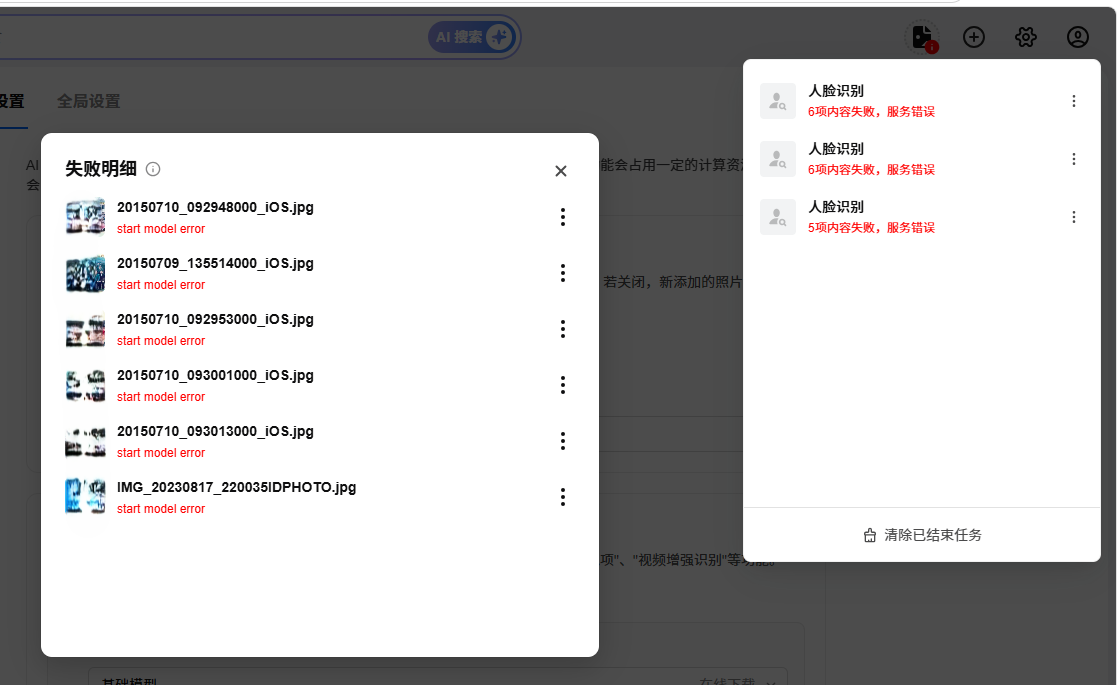

2026-4-9 22:29:27 显示全部楼层
hgs250237100 发表于 2026-4-5 09:04
我的设备是某RK3566 T ,首次安装飞牛在内置的emmc里面,AI模型是可以正常使用的。后来重新刷系统,并且把 ...

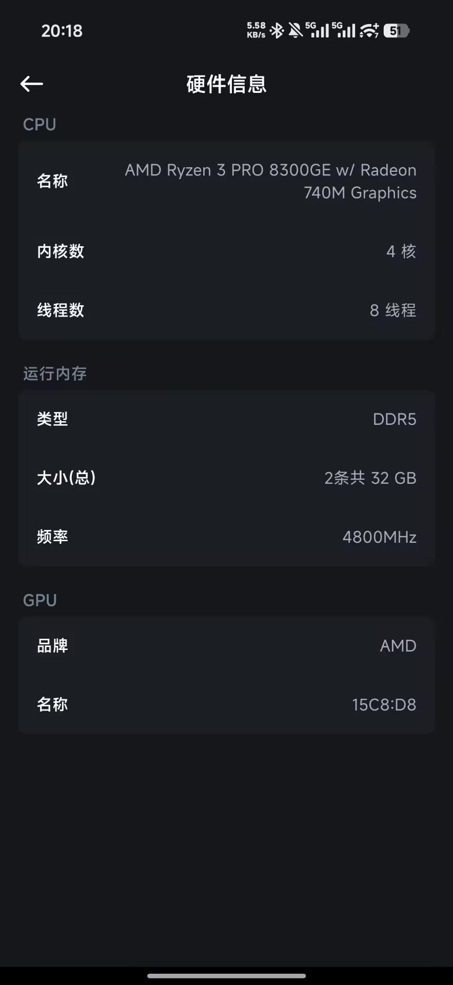

2026-4-18 21:51:59 显示全部楼层
飞牛os 1.1.29版本,相册ai功能不识别我这个核显。AMD Ryzen 3 PRO 8300GE w/ Radeon 740M Graphics

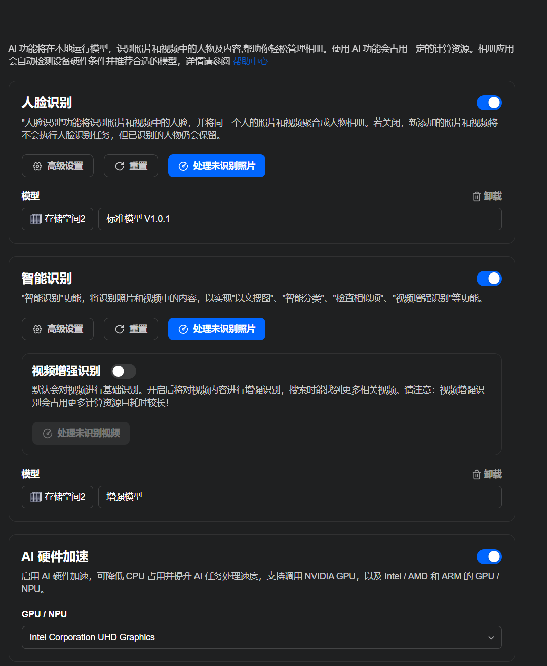

2026-5-15 10:45:44 显示全部楼层
intel hd500 以及 锐炬xe显卡打开GPU开关显示调用成功,但是GPU毫无占用。CPU疯狂在跑。
