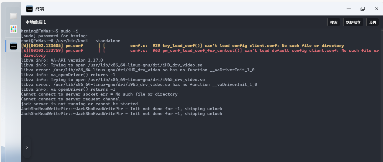

2025-12-11 12:03:23 显示全部楼层
启动报错,这是撒情况呢?
  1. root@FnNas:~# kodi
  2. [W][99171.471305] pw.conf      | [          conf.c:  939 try_load_conf()] can't load config client.conf: No such file or directory
  3. [E][99171.471363] pw.conf      | [          conf.c:  963 pw_conf_load_conf_for_context()] can't load default config client.conf: No such file or directory
  4. libva info: VA-API version 1.17.0
  5. libva info: Trying to open /usr/lib/x86_64-linux-gnu/dri/iHD_drv_video.so
  6. libva error: /usr/lib/x86_64-linux-gnu/dri/iHD_drv_video.so has no function __vaDriverInit_1_0
  7. libva info: va_openDriver() returns -1
  8. libva info: Trying to open /usr/lib/x86_64-linux-gnu/dri/i965_drv_video.so
  9. libva error: /usr/lib/x86_64-linux-gnu/dri/i965_drv_video.so has no function __vaDriverInit_1_0
  10. libva info: va_openDriver() returns -1
  11. Cannot connect to server socket err = No such file or directory
  12. Cannot connect to server request channel
  13. jack server is not running or cannot be started
  14. JackShmReadWritePtr::~JackShmReadWritePtr - Init not done for -1, skipping unlock
  15. JackShmReadWritePtr::~JackShmReadWritePtr - Init not done for -1, skipping unlock
复制代码
