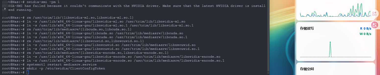

替换fnOS自带的libnvidia-ml.so
使用以下的shell命令,把fnOS的libnvidia-ml替换了
rm /usr/trim/lib/{libnvidia-ml.so,libnvidia-ml.so.1}
ln -s /usr/lib/x86_64-linux-gnu/libnvidia-ml.so /usr/trim/lib/libnvidia-ml.so
ln -s /usr/lib/x86_64-linux-gnu/libnvidia-ml.so.1 /usr/trim/lib/libnvidia-ml.so.1
如果不替换libnvidia-ml也可以用,但是fnOS的资源监控不能显示
高版本下mediasrv,需要自行替换或者是放置相关库 至于什么算高版本那就不知道了,至少version 0.8.16是这样 否则可以开启GPU加速但是会报错,报错文案形如
root@fnOS-device:/usr/trim/lib/mediasrv# /usr/trim/bin/mediasrv -o /usr/trim/logs/mediasrv.log -a /var/run/mediasrv.socket
[ne]max connections: 300 (75 per worker), workers: 4
[ne]socket timeout: 60s
[hevc @ 0x563eed594000] Invalid setup for format vaapi: does not match the type of the provided device context.
[hevc @ 0x563eed594000] decoder->cvdl->cuvidCreateDecoder(&decoder->decoder, params) failed -> CUDA_ERROR_NO_DEVICE: no CUDA-capable device is detected
[hevc @ 0x563eed594000] Failed setup for format cuda: hwaccel initialisation returned error.
[hevc @ 0x563eed594400] Could not find ref with POC 0
[hevc @ 0x563eed594800] Could not find ref with POC 0
[hevc @ 0x563eed594c00] Could not find ref with POC 0
[hevc @ 0x563eed595000] Could not find ref with POC 0
[hevc @ 0x563eed595400] Could not find ref with POC 0
[hevc @ 0x563eed595800] Could not find ref with POC 0
[hevc @ 0x563eed595c00] Could not find ref with POC 0
[hevc @ 0x563eedbb2000] Could not find ref with POC 0
报错的文案令人迷惑,但是这个在替换相关库之后就能修复 以下命令执行如果出现rm失败的不用理会,继续执行剩余命令即可
rm /usr/trim/lib/mediasrv/{libcuda.so,libcuda.so.1}
ln -s /usr/lib/x86_64-linux-gnu/libcuda.so /usr/trim/lib/mediasrv/libcuda.so
ln -s /usr/lib/x86_64-linux-gnu/libcuda.so /usr/trim/lib/mediasrv/libcuda.so.1
rm /usr/trim/lib/mediasrv/{libnvcuvid.so,libnvcuvid.so.1}
ln -s /usr/lib/x86_64-linux-gnu/libnvcuvid.so /usr/trim/lib/mediasrv/libnvcuvid.so
ln -s /usr/lib/x86_64-linux-gnu/libnvcuvid.so /usr/trim/lib/mediasrv/libnvcuvid.so.1
rm /usr/trim/lib/mediasrv/{libnvidia-encode.so,libnvidia-encode.so.1}
ln -s /usr/lib/x86_64-linux-gnu/libnvidia-encode.so /usr/trim/lib/mediasrv/libnvidia-encode.so
ln -s /usr/lib/x86_64-linux-gnu/libnvidia-encode.so /usr/trim/lib/mediasrv/libnvidia-encode.so.1
随后重启mediasrv服务即可正常使用nvidia编解码功能
systemctl restart mediasrv.service

怎么切换persistence modefunk 小白不懂
nvidia-smi -pm 1  详情 回复

玲1746 发表于 2026-2-28 14:41
怎么切换persistence mode 小白不懂
nvidia-smi -pm 1
指令运行完后没有反应,下载vGPU授权在哪里下载,我没找到有关文章。  详情 回复

[quote][size=2][url=forum.php?mod=redirect&goto=findpost&pid=261178&ptid=2341][color=#999999]陪玩 发表于 2026-2-28 15:13[/color][/url][/size] nvidia-smi -pm 1[/quote]
你这个驱动本体都没加载成功,你看看编译有没有什么问题  详情 回复
