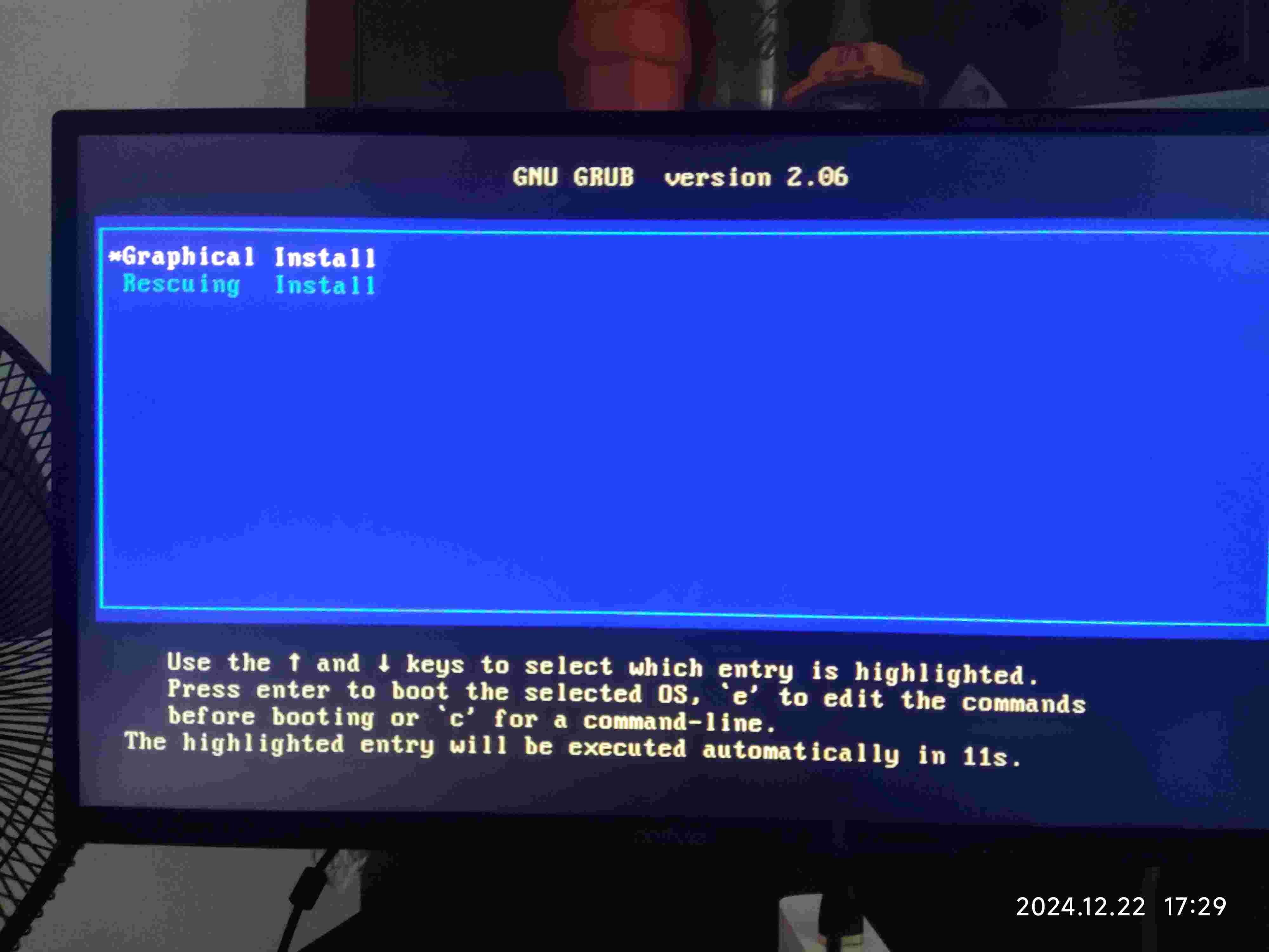

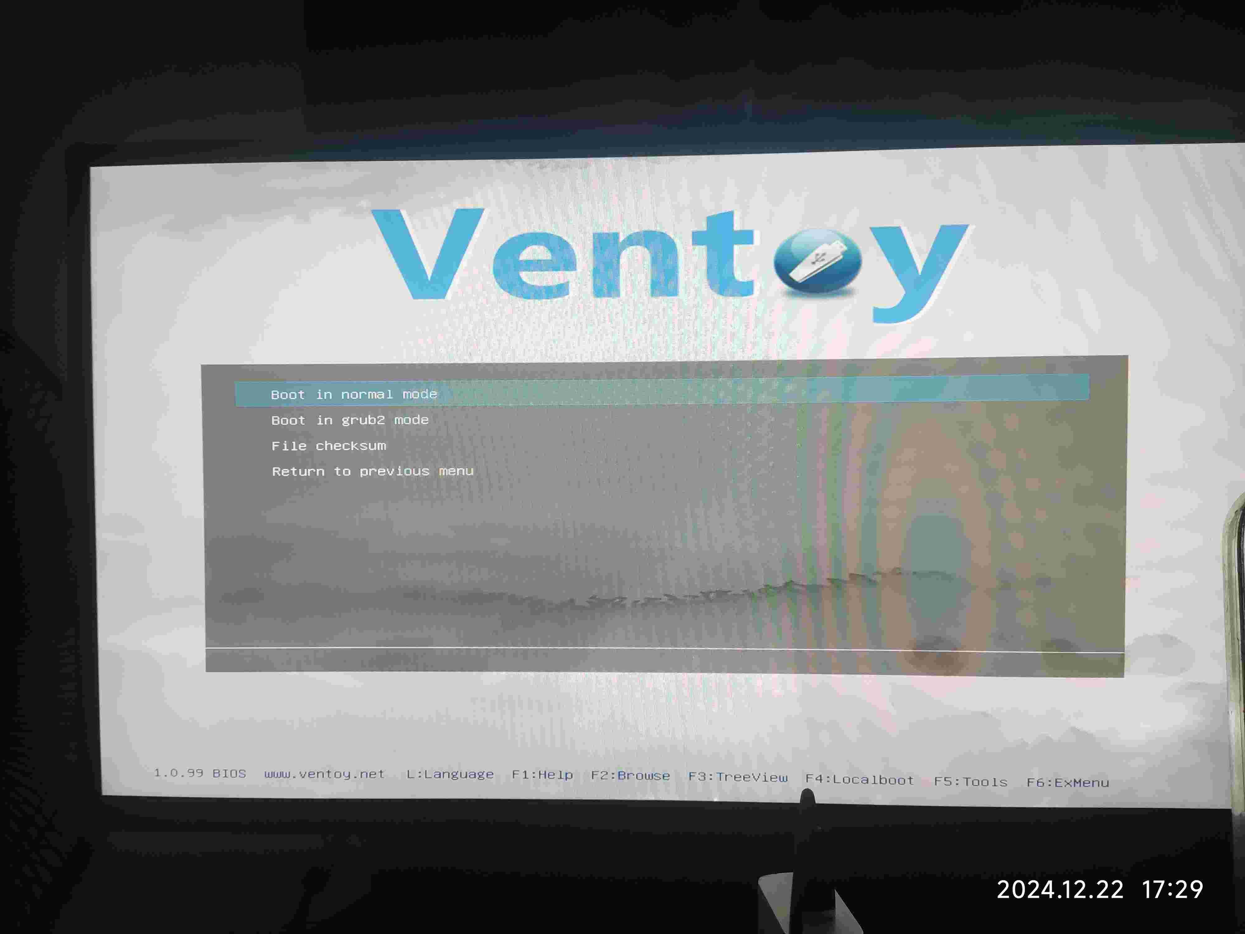

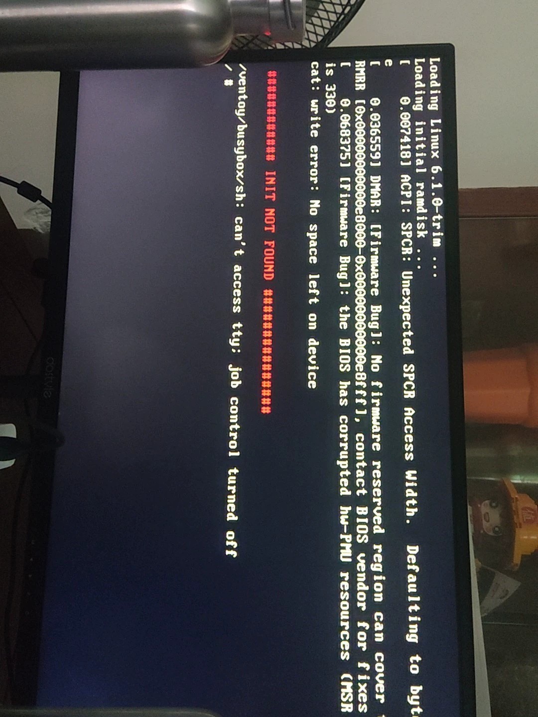

2024-12-22 22:27:14 显示全部楼层
帅哥,在ventoy界面选了boot in normal mode后,跳出选择Graphical install ,然后就提示出错,请问是U盘制作出错了还是啥情况?
[md]![QQ图片20241222223353.jpg](data/attachment/forum/202412/22/223512o4htzgph444o48op.jpg "QQ图片20241222223353.jpg") ![QQ图片20241222222928.jpg](data/attachment/forum/202412/22/223522flse33v1vbaryk  详情 回复
