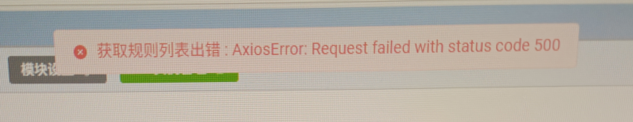

屏幕截图2026-01-22085021.png每次重启后lucky反代失效,需要重启lucky应用,重启后就恢复正常了。lucky卸载重装过,问题依旧。大神?是否知道哪里出了问题?
以下是日志
[31m2026/01/22 08:39:31 [Recovery] 2026/01/22 - 08:39:31 panic recovered: runtime error: invalid memory address or nil pointer dereference C:/Program Files/Go/src/runtime/panic.go:262 (0x484158) C:/Program Files/Go/src/runtime/signal_unix.go:925 (0x484128) C:/Program Files/Go/src/sync/atomic/type.go:94 (0x2967bda) C:/Program Files/Go/src/sync/rwmutex.go:72 (0x2967be1) gdy/lucky_own/modules/webservice/conf/rule.go:152 (0x2967bce) gdy/lucky_own/modules/webservice/options/data.go:213 (0x29843a8) gdy/lucky_own/modules/webservice/api/api.go:576 (0x2994a1e) pkg/mod/github.com/gin-gonic/gin@v1.11.0/context.go:192 (0xafce6d) gdy/gdylib/luckyweb/gin.go:447 (0xe84d8e) pkg/mod/github.com/gin-gonic/gin@v1.11.0/context.go:192 (0xafce6d) gdy/gdylib/luckyweb/gin.go:92 (0xe85bfa) pkg/mod/github.com/gin-gonic/gin@v1.11.0/context.go:192 (0xafce6d) pkg/mod/github.com/gin-contrib/gzip@v1.2.5/handler.go:105 (0xe22764) pkg/mod/github.com/gin-gonic/gin@v1.11.0/context.go:192 (0xafce6d) pkg/mod/github.com/gin-gonic/gin@v1.11.0/recovery.go:92 (0xb0b110) pkg/mod/github.com/gin-gonic/gin@v1.11.0/context.go:192 (0xafce6d) pkg/mod/github.com/gin-gonic/gin@v1.11.0/gin.go:689 (0xb09254) pkg/mod/github.com/gin-gonic/gin@v1.11.0/gin.go:643 (0xb08bec) gdy/gdylib/luckyweb/gin.go:265 (0xe864bd) C:/Program Files/Go/src/net/http/server.go:3340 (0x79486d) C:/Program Files/Go/src/net/http/server.go:2109 (0x772104) C:/Program Files/Go/src/runtime/asm_amd64.s:1693 (0x48a420) [0m

我也是有这个bug,飞牛重启后第一次lucky就会这样,找不到配置文件了好像是

在等等吧,我们协助官方排查一下,最近几次系统更新才出现的问题,跟系统有点关系

upload 附件:Lucky.zip可以试试看这个,加入了延时启动,应该能解决

装了楼上徐大大的加入了延时启动的版本恢复正常了,应用商店的怎么不同步更新呢,应该有很多人和我一样啊
