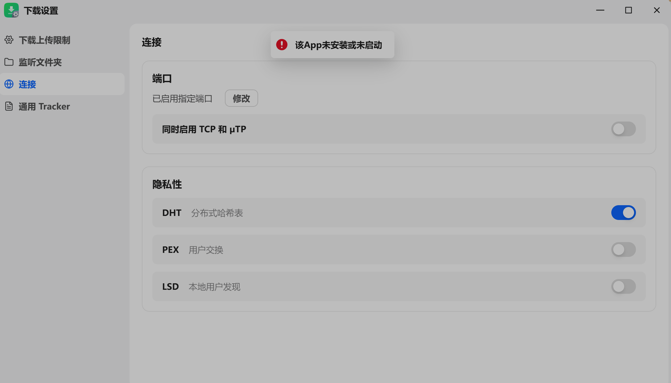

设备环境:
某神秘热门rk3566 turbo盒子,局域网连接,系统版本号1.1.20
BUG现象:
(我通过xx设备访问,经过xxx操作后,出现了xxx情况,若有现场截图或者视频可以上传)我通过电脑访问,在打开飞牛的下载app时,app无法启动,如图
出现频率:
毕现
联系方式:
steelway108@icloud.com
日志文件:
我已经查出了问题所在,下载app要2.11版本的库,但是我查询系统盘内只有2.9版本的库,这部分日志内容如下
root@某RK3566 T :~# journalctl -u dlcenter.service -n 20
Feb 12 20:27:28 某RK3566 T systemd[1]: dlcenter.service: Failed with result 'exit-code'.
Feb 12 20:27:33 某RK3566 T systemd[1]: dlcenter.service: Scheduled restart **, restart counter is at 84.
Feb 12 20:27:33 某RK3566 T systemd[1]: Stopped dlcenter.service - trim download center Service.
Feb 12 20:27:33 某RK3566 T systemd[1]: Started dlcenter.service - trim download center Service.
Feb 12 20:27:33 某RK3566 T dlcenter[5171]: /usr/trim/bin/dlcenter: error while loading shared libraries: libframework.so.2.11>
Feb 12 20:27:33 某RK3566 T systemd[1]: dlcenter.service: Main process exited, code=exited, status=127/n/a
Feb 12 20:27:33 某RK3566 T systemd[1]: dlcenter.service: Failed with result 'exit-code'.
Feb 12 20:27:38 某RK3566 T systemd[1]: dlcenter.service: Scheduled restart **, restart counter is at 85.
Feb 12 20:27:38 某RK3566 T systemd[1]: Stopped dlcenter.service - trim download center Service.
Feb 12 20:27:38 某RK3566 T systemd[1]: Started dlcenter.service - trim download center Service.
Feb 12 20:27:38 某RK3566 T dlcenter[5191]: /usr/trim/bin/dlcenter: error while loading shared libraries: libframework.so.2.11>
Feb 12 20:27:38 某RK3566 T systemd[1]: dlcenter.service: Main process exited, code=exited, status=127/n/a
Feb 12 20:27:38 某RK3566 T systemd[1]: dlcenter.service: Failed with result 'exit-code'.
Feb 12 20:27:44 某RK3566 T systemd[1]: dlcenter.service: Scheduled restart **, restart counter is at 86.
Feb 12 20:27:44 某RK3566 T systemd[1]: Stopped dlcenter.service - trim download center Service.
Feb 12 20:27:44 某RK3566 T systemd[1]: Started dlcenter.service - trim download center Service.
我建立了欺骗链接,
cd /usr/trim/lib/
sudo ln -s libframework.so.2.9 libframework.so.2.11
目前下载倒是能用了,不过还是希望尽快修复这个问题。
顺便一提,我是刷完机之后使用了还原系统配置的功能,难道这次出错跟这个有关系?
