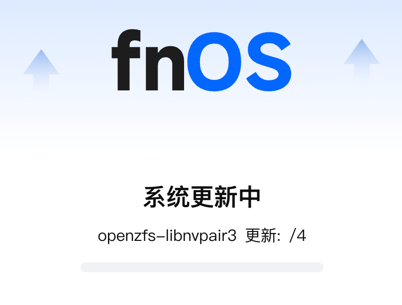

飞牛升级一直报错,只有 ZFS 的这个包一直安装不了
558
飞牛百度网盘玩家
2026-2-13 00:55:54 显示全部楼层 阅读模式

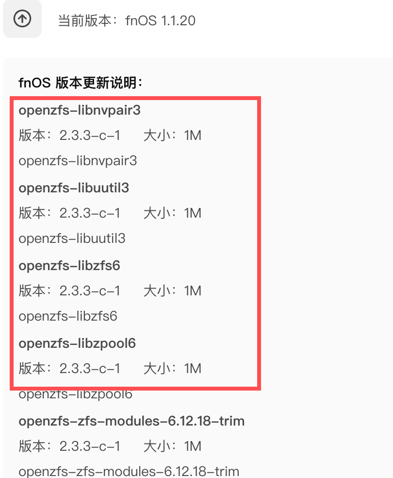

在页面升级一直被卡在
手动在终端升级报错:failed to install 'openzfs-libnvpair3' ,感觉还是 apt 源有问题,但是手动 修复几次成功后,还是没有安装
root@HP ~# liveupdate -p 57 -r 698e022b698e0226000000000027 -u
trim-update[1760968]: starting update...
{"msg":"","code":0,"data":true}{"msg":"","code":0,"data":true}{"msg":"","code":0,"data":true}{"msg":"","code":0,"data":true}[[ WEXITSTATUS: 0 /var/tmp/trim-update/preupdate-3.47.sh ]]
trim-update[1760968]: updating 'openzfs-libnvpair3'...
{"msg":"","code":0,"data":true}[[ WEXITSTATUS: 1 dpkg ]]
trim-update[1760968]: failed to install 'openzfs-libnvpair3'.
trim-update[1760968]: failed to update 'openzfs-libnvpair3'.
{"msg":"","code":0,"data":true}⏎
2026-2-13 02:59:19 显示全部楼层
好像是依赖问题导致的,看看这个吧https://club.fnnas.com/forum.php?mod=viewthread&tid=33052&extra=page%3D1

2026-2-13 11:30:13 显示全部楼层
可以换源
