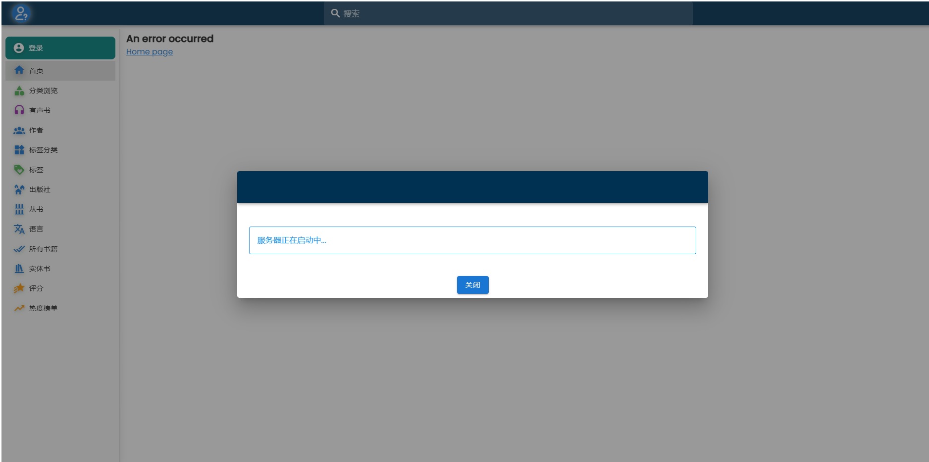

我用电脑主机(X86)搭建的飞牛,用docker安装talebook时,严格按照配置去设置了,镜像也拉下来了,docker运行后,用网页登录默认的8082端口,talebook一直显示“服务器正在启动中”,尝试多次也这,不知道问题出在哪里,哪位大佬能否帮帮忙指点一下,非常感谢!

运行日志如下,麻烦各位大佬帮忙看看
====== Start Server ====
2026-03-30 13:41:02,683 INFO Included extra file "/etc/supervisor/conf.d/talebook.conf" during parsing
2026-03-30 13:41:02,683 INFO Set uid to user 0 succeeded
2026-03-30 13:41:02,687 INFO RPC interface 'supervisor' initialized
2026-03-30 13:41:02,687 CRIT Server 'unix_http_server' running without any HTTP authentication checking
2026-03-30 13:41:02,687 INFO supervisord started with pid 1
2026-03-30 13:41:03,692 INFO spawned: 'tornado' with pid 38
2026-03-30 13:41:03,699 INFO spawned: 'nginx' with pid 39
error: exec: "python3": executable file not found in $PATH
2026-03-30 13:41:03,712 WARN exited: tornado (exit status 1; not expected)
2026-03-30 13:41:04,737 INFO spawned: 'tornado' with pid 49
2026-03-30 13:41:04,738 INFO success: nginx entered RUNNING state, process has stayed up for > than 1 seconds (startsecs)
2026-03-30 13:41:04,752 WARN exited: tornado (exit status 1; not expected)
2026-03-30 13:41:06,759 INFO spawned: 'tornado' with pid 55
2026-03-30 13:41:06,773 WARN exited: tornado (exit status 1; not expected)
2026-03-30 13:41:09,781 INFO spawned: 'tornado' with pid 61
2026-03-30 13:41:09,795 WARN exited: tornado (exit status 1; not expected)
2026-03-30 13:41:10,797 INFO gave up: tornado entered FATAL state, too many start retries too quickly
系统找不到 python3 命令,导致 tornado 服务启动失败。  详情 回复
安装 python3 即可恢复正常。应用商店里有。

我昨天已经安装了python3.1.0 和3.9版本,都不行,唉

昨天晚上下载了talebook v3.38.0镜像,重新构建,还是显示“服务器正在启动中”,无法正常运行
运行日志如下:
updating '/data/' permission to 1000:1000
====== Check config ====
nginx: the configuration file /etc/nginx/nginx.conf syntax is ok
nginx: configuration file /etc/nginx/nginx.conf test is successful
====== Sync DB Scheme ====
error: exec failed: permission denied
====== Update Server Config ====
2026-03-31 02:11:38,195 INFO Included extra file "/etc/supervisor/conf.d/talebook.conf" during parsing
2026-03-31 02:11:38,195 INFO Set uid to user 0 succeeded
2026-03-31 02:11:38,201 INFO RPC interface 'supervisor' initialized
2026-03-31 02:11:38,201 CRIT Server 'unix_http_server' running without any HTTP authentication checking
2026-03-31 02:11:38,202 INFO supervisord started with pid 1
2026-03-31 02:11:39,207 INFO spawned: 'tornado' with pid 46
2026-03-31 02:11:39,212 INFO spawned: 'nginx' with pid 47
2026-03-31 02:11:39,224 WARN exited: tornado (exit status 1; not expected)
2026-03-31 02:11:40,256 INFO spawned: 'tornado' with pid 57
2026-03-31 02:11:40,257 INFO success: nginx entered RUNNING state, process has stayed up for > than 1 seconds (startsecs)
2026-03-31 02:11:40,270 WARN exited: tornado (exit status 1; not expected)
2026-03-31 02:11:42,274 INFO spawned: 'tornado' with pid 63
2026-03-31 02:11:42,282 WARN exited: tornado (exit status 1; not expected)
2026-03-31 02:11:45,292 INFO spawned: 'tornado' with pid 69
2026-03-31 02:11:45,307 WARN exited: tornado (exit status 1; not expected)
2026-03-31 02:11:46,308 INFO gave up: tornado entered FATAL state, too many start retries too quickly
