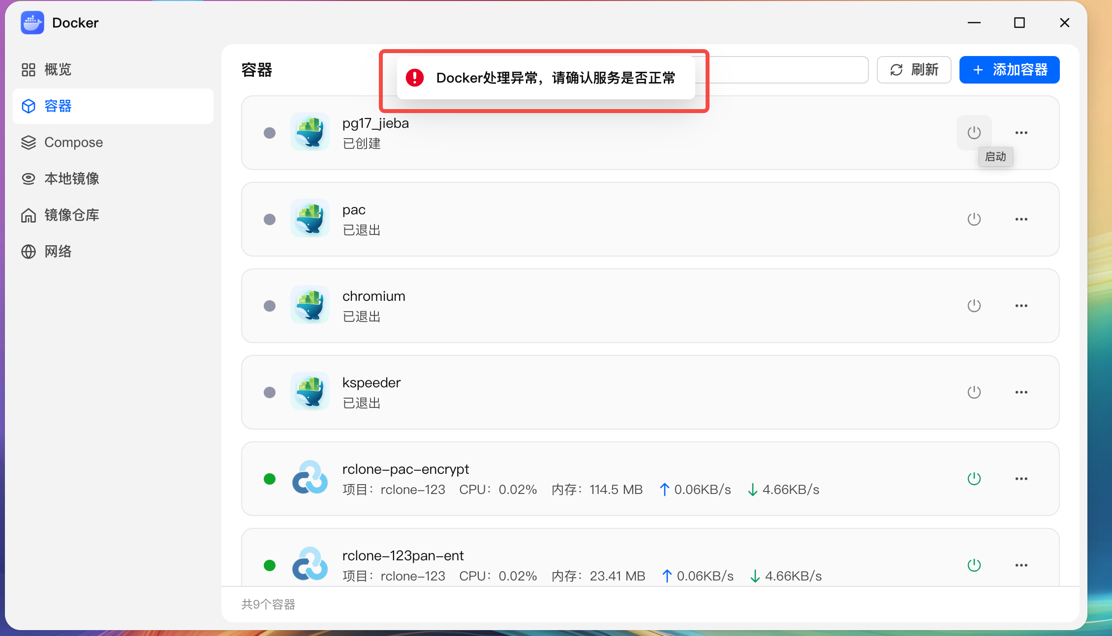

我在fnOS上启动postgresql,一直报错“Docker处理异常,请确认服务是否正常”
无任何其他异常提示。一直以为是挂载目录问题,调试无果。
后台docker logs 容器id,也是没有日志消息。
使用一下命令检查日志
journalctl -f
发现原来端口被占用时会提示此错误信息。
May 16 22:06:10 fnOS dockermgr[1288670]: May 16 21:45:31 fnOS dockerd[1233425]: time="2026-05-16T21:45:31.697739560+08:00" level=error msg="Handler for POST /containers/d5f12f8b119980f70945bb8932b34f127d849efff21c2f2d0c10f18a5347ab51/start returned error: failed to set up container networking: driver failed programming external connectivity on endpoint pg17_jieba (63cf89efb8855348d87503fbe8e2b7fb6bf5319782350f65d941c5f3a75f4980): failed to bind host port for 0.0.0.0:5432:172.17.0.2:5432/tcp: address already in use"
May 16 22:06:10 fnOS dockermgr[1288670]: May 16 21:48:16 fnOS dockerd[1233425]: time="2026-05-16T21:48:16.212266973+08:00" level=error msg="Handler for POST /containers/62983f83d4338d990afba1ff2a21349eab9d89861ab5162f2c024a55d9930f17/start returned error: failed to set up container networking: driver failed programming external connectivity on endpoint pg17_jieba (97b46246f98d087704a2e552727606eaf7f415eed607955510ee98e038aa4beb): failed to bind host port for 0.0.0.0:5432:172.17.0.2:5432/tcp: address already in use"

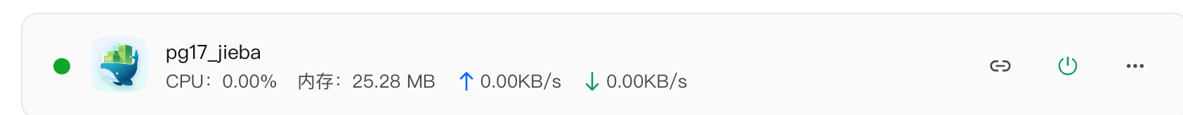

将端口号5432改为15432,成功启动

是的,只是这个错误会导致提示错误为“Docker处理异常,请确认服务是否正常”。就是这个docker服务启动失败的错误提示逻辑可能要调整,可能还有其他异常恐怕也会提示这样的错误。  详情 回复
