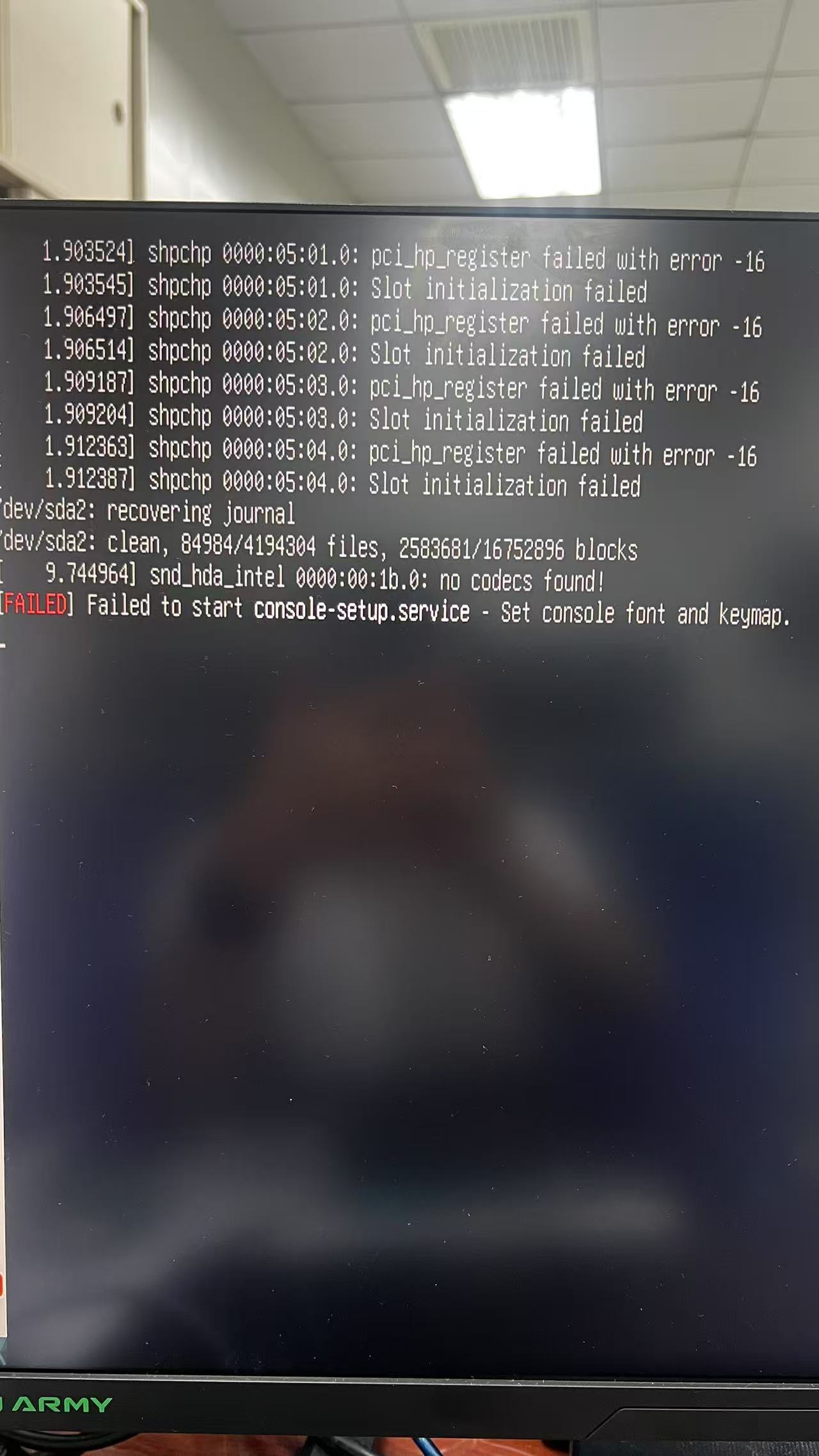

大佬,我pve是8.4.1,然后硬件有直通的设备,“硬件”中“显示”选“无(none)”,pci设备也有核显了,但是,启动后,vnc进不去,同时,fnos没有ip分配,进不去是咋回事

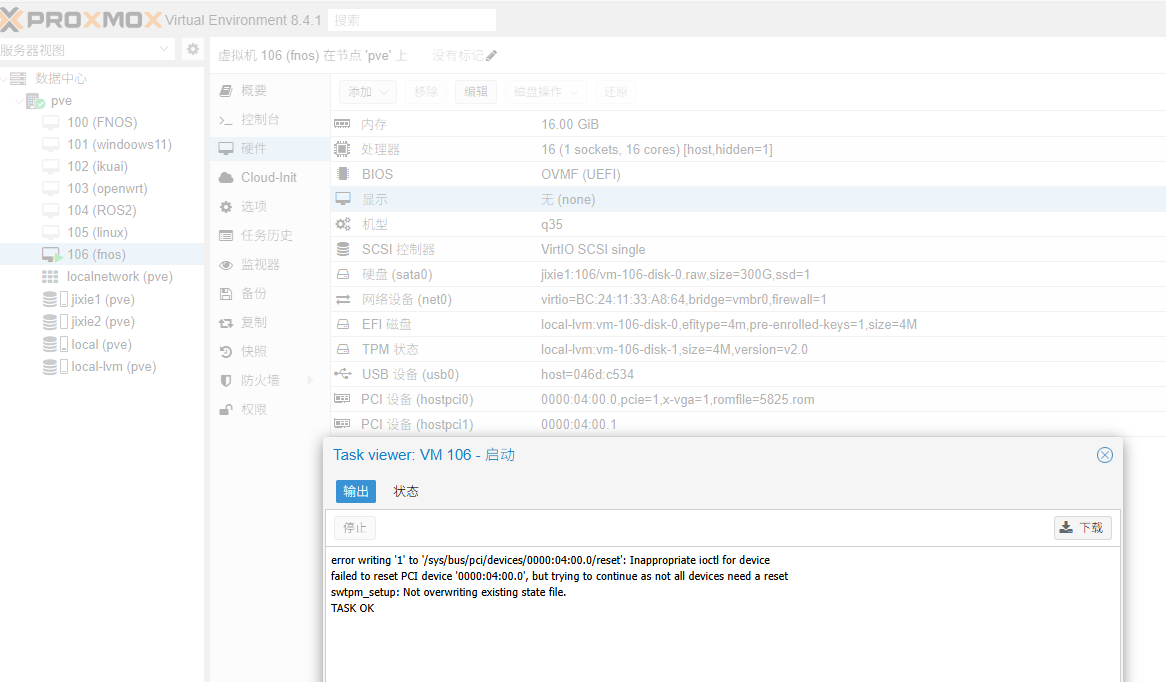

求助一下,按照教程到启动时,跳出这个:error writing '1' to '/sys/bus/pci/devices/0000:07:00.0/reset': Inappropriate ioctl for device
failed to reset PCI device '0000:07:00.0', but trying to continue as not all devices need a reset
TASK ERROR: start failed: QEMU exited with code 1
