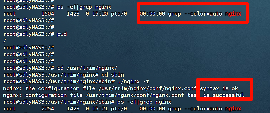

ssh登录检查nginx状态
nginx没启动,没经常,nginx -t测试配置没问题

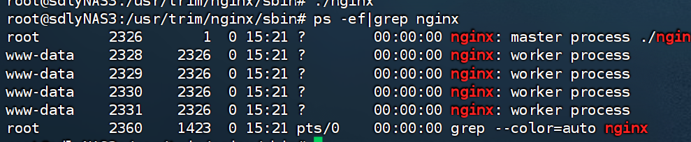

直接运行./nginx,后正常

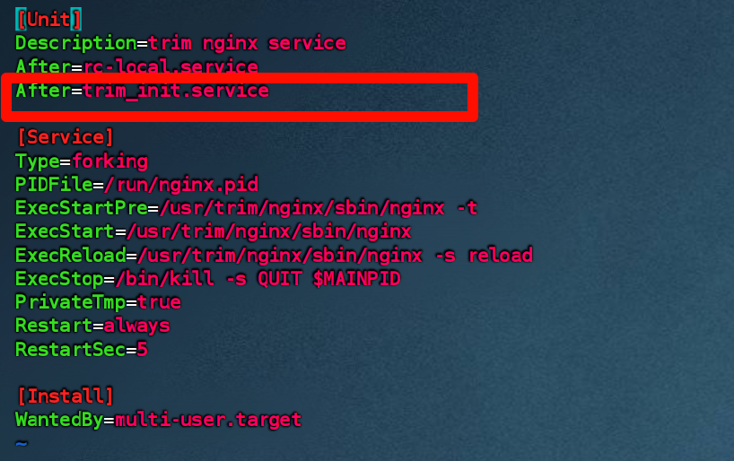

问题分析:是不是原来有第二个磁盘空间,摘除后换另一块因没初始化,导致系统启动服务异常,
尤其是nginx的服务。nginx服务依赖trim_init,可能是因缺少第二个硬盘空间,导致初始化失败
nginx服务没启动。

补充一下:确实是nginx由于依赖问题没启动
root@sdlyNAS3:/# systemctl status trim_init
● trim_init.service - trim init service
     Loaded: loaded (/etc/systemd/system/trim_init.service; enabled; preset: enabled)
     Active: activating (start) since Thu 2025-02-27 15:38:42 CST; 19s ago
   Main PID: 1158 (triminit)
      Tasks: 3 (limit: 9361)
     Memory: 6.4M
        CPU: 239ms
     CGroup: /system.slice/trim_init.service
             **─1158 /usr/trim/bin/triminit
Feb 27 15:38:42 sdlyNAS3 systemd[1]: Starting trim_init.service - trim init service...
Feb 27 15:38:43 sdlyNAS3 triminit[1242]: ...+...............+...+............+....+.........+...........+.+++++++++++++>
Feb 27 15:38:43 sdlyNAS3 triminit[1242]: .....+...........+.+..............+....+++++++++++++++++++++++++++++++++++++++>
Feb 27 15:38:43 sdlyNAS3 triminit[1242]: -----
root@sdlyNAS3:/# systemctl status trim_nginx
○ trim_nginx.service - trim nginx service
     Loaded: loaded (/etc/systemd/system/trim_nginx.service; enabled; preset: enabled)
     Active: inactive (dead)
过大约3分钟后,会启动nginx,也不算BUG吧
