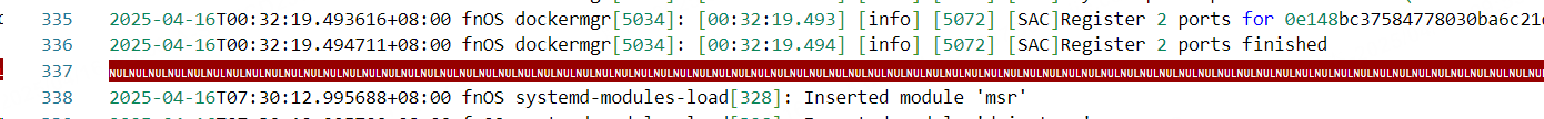

今早出现无法访问现象 接入HDMI后显示屏无任何显示(无信号) syslog中 00:32:19-07:30:12期间的日志丢失 内核日志如下 root@fnOS:/# dmesg -T | grep -iE "error|fail|warning|temperature|throttle|hardwar  详情 回复

2025-4-16 09:56:32 楼主 显示全部楼层
[quote][size=2][url=forum.php?mod=redirect&goto=findpost&pid=105261&ptid=21885][color=#999999]飞牛技术同学 发表于 2025-4-15 16:45[/color][/url][/size] 1.可以在接入显示屏看看死机前有什么信息输出 2.如果cpu占用不高可以排查一下gpu的情况 如果需要协助排查可 ...[/quote]
今早出现无法访问现象
  1. 接入HDMI后显示屏无任何显示(无信号)
  2. syslog中 00:32:19-07:30:12期间的日志丢失
  3. 内核日志如下
    root@fnOS:/# dmesg -T | grep -iE "error|fail|warning|temperature|throttle|hardware"
    [Wed Apr 16 07:30:07 2025] x86/split lock detection: #AC: crashing the kernel on kernel split_locks and warning on user-space split_locks
    [Wed Apr 16 07:30:07 2025] Booting paravirtualized kernel on bare hardware
    [Wed Apr 16 07:30:07 2025] fjes: module verification failed: signature and/or required key missing - tainting kernel
    [Wed Apr 16 07:30:08 2025] mmc0: Failed to initialize a non-removable card
    [Wed Apr 16 07:30:11 2025] i915 0000:00:02.0: [drm] *ERROR* Unexpected child device config size 40 (expected 39 for VBT version 256)
    [Wed Apr 16 07:30:20 2025] traps: finder_service[1502] trap int3 ip:55889c845563 sp:7ffd6611ba60 error:0 in finder_service[55889c7e4000+6e000]
    [Wed Apr 16 07:30:20 2025] traps: dlcenter[1510] trap int3 ip:5622b8d46513 sp:7ffc67de9a30 error:0 in dlcenter[5622b8c29000+122000]
    [Wed Apr 16 07:30:20 2025] traps: mountmgr[1635] trap int3 ip:565213af75b6 sp:7fff96306660 error:0 in mountmgr[565213a91000+8f000]
    [Wed Apr 16 07:30:21 2025] traps: imagesrv[1867] trap int3 ip:55f3dbe5f7c3 sp:7ffee7144470 error:0 in imagesrv[55f3dbdbb000+aa000]
  4. 系统日志syslog,在7:30附近的日志

    Apr 16 07:30:21 fnOS kernel: traps: finder_service[1502] trap int3 ip:55889c845563 sp:7ffd6611ba60 error:0 in finder_service[55889c7e4000+6e000]
    Apr 16 07:30:21 fnOS kernel: traps: dlcenter[1510] trap int3 ip:5622b8d46513 sp:7ffc67de9a30 error:0 in dlcenter[5622b8c29000+122000]
    Apr 16 07:30:21 fnOS finder_service[1477]: [1477:1477:20250416,073021.702018:WARNING spawn_subprocess.cc:245] intermediate process terminated by signal 5 (Trace/breakpoint trap)
    Apr 16 07:30:21 fnOS kernel: traps: mountmgr[1635] trap int3 ip:565213af75b6 sp:7fff96306660 error:0 in mountmgr[565213a91000+8f000]
    Apr 16 07:30:21 fnOS dlcenter[1469]: [1469:1469:20250416,073021.708090:WARNING spawn_subprocess.cc:245] intermediate process terminated by signal 5 (Trace/breakpoint trap)
    Apr 16 07:30:21 fnOS mountmgr[1491]: [1491:1491:20250416,073021.734371:WARNING spawn_subprocess.cc:251] intermediate process terminated by signal 5 (Trace/breakpoint trap)
    Apr 16 07:30:21 fnOS mountmgr[1491]: [1491:1491:20250416,073021.734480:ERROR socket.cc:93] sendmsg: Broken pipe (32)
    Apr 16 07:30:21 fnOS share_service[1498]: sd_bus_call: Failed to call dbus method:StopUnit:-2
    Apr 16 07:30:21 fnOS share_service[1498]: sd_bus_call: Failed to call dbus method:DisableUnitFiles:-2
    Apr 16 07:30:22 fnOS cloud_storage_dav[1496]: time="2025-04-16T07:30:22+08:00" level=warning msg="not enable search" file="/app/internal/search/search.go:35"
    Apr 16 07:30:22 fnOS kernel: traps: imagesrv[1867] trap int3 ip:55f3dbe5f7c3 sp:7ffee7144470 error:0 in imagesrv[55f3dbdbb000+aa000]
    Apr 16 07:30:22 fnOS imagesrv[1479]: [1479:1479:20250416,073022.225251:WARNING spawn_subprocess.cc:245] intermediate process terminated by signal 5 (Trace/breakpoint trap)
    Apr 16 07:30:23 fnOS dockerd[1472]: time="2025-04-16T07:30:23.140757246+08:00" level=warning msg="Error (Unable to complete atomic operation, key modified) deleting object [endpoint a272b0ce6be02f16a352d5b27350acb03e1bd587d9563f4177ce84eae0700fb9 1fc93e1f6f9bf1c9d31c891b0bbd21888b8c8fcc6ba5c81dd628b48cc3b9dc78], retrying...."
    Apr 16 07:30:23 fnOS dockerd[1472]: time="2025-04-16T07:30:23.426720353+08:00" level=warning msg="Error (Unable to complete atomic operation, key modified) deleting object [endpoint a272b0ce6be02f16a352d5b27350acb03e1bd587d9563f4177ce84eae0700fb9 b0696d96d1b357fdc6ddfbcfd1f0bc097da4006087aeb9f92605d657b6ecd43f], retrying...."
    Apr 16 07:30:23 fnOS dockerd[1472]: time="2025-04-16T07:30:23.582463676+08:00" level=warning msg="Error (Unable to complete atomic operation, key modified) deleting object [endpoint 37dd62b1cad2a22b593f94030d9f61a9058787a288dc3d0772703b5143ac2b6b 2771cf637a171a3e4d220acd509f7ccc58bc282815bd9a974d766e496a36a318], retrying...."
    Apr 16 07:30:23 fnOS dockerd[1472]: time="2025-04-16T07:30:23.653137127+08:00" level=warning msg="Error (Unable to complete atomic operation, key modified) deleting object [endpoint a272b0ce6be02f16a352d5b27350acb03e1bd587d9563f4177ce84eae0700fb9 3648648c9de088a480ccd9927fa494ceea0593337a8989401fc9d73704d1531e], retrying...."
    Apr 16 07:30:23 fnOS dockerd[1472]: time="2025-04-16T07:30:23.858339048+08:00" level=warning msg="Error (Unable to complete atomic operation, key modified) deleting object [endpoint a272b0ce6be02f16a352d5b27350acb03e1bd587d9563f4177ce84eae0700fb9 c9ec13c07bfbfc72ceeaf8a3419155cab23223a8d1c21b3e252a320e5fd892a7], retrying...."
    Apr 16 07:30:24 fnOS dockerd[1472]: time="2025-04-16T07:30:24.000946624+08:00" level=warning msg="Error (Unable to complete atomic operation, key modified) deleting object [endpoint a272b0ce6be02f16a352d5b27350acb03e1bd587d9563f4177ce84eae0700fb9 be2ffa111cf521211ae7ac1d87b2c538ae49d3dce13da40ddd5a8f1b7c1a0b20], retrying...."
    Apr 16 07:30:24 fnOS dockerd[1472]: time="2025-04-16T07:30:24.249873158+08:00" level=warning msg="Error (Unable to complete atomic operation, key modified) deleting object [endpoint a272b0ce6be02f16a352d5b27350acb03e1bd587d9563f4177ce84eae0700fb9 1db7270e00c8a9beb69d8610ffd52bbafe0149074ec1a55ed2e9c5d4385171ac], retrying...."
    Apr 16 07:30:24 fnOS dockerd[1472]: time="2025-04-16T07:30:24.318304540+08:00" level=warning msg="Error (Unable to complete atomic operation, key modified) deleting object [endpoint a272b0ce6be02f16a352d5b27350acb03e1bd587d9563f4177ce84eae0700fb9 58900638957aa31c23fd3ffb624f6ba482115cd81ec45ff1509eba0e85dab3ef], retrying...."
    Apr 16 07:30:24 fnOS dockerd[1472]: time="2025-04-16T07:30:24.410307901+08:00" level=warning msg="Error (Unable to complete atomic operation, key modified) deleting object [endpoint a272b0ce6be02f16a352d5b27350acb03e1bd587d9563f4177ce84eae0700fb9 cd99c5063328b38b6d32baf754878a8d78876333dbb097d41b9b8d481847bbfa], retrying...."
    Apr 16 07:30:24 fnOS dockerd[1472]: time="2025-04-16T07:30:24.518601016+08:00" level=warning msg="Error (Unable to complete atomic operation, key modified) deleting object [endpoint a272b0ce6be02f16a352d5b27350acb03e1bd587d9563f4177ce84eae0700fb9 92ce4c61d375023e2ad7cebcef605307c943af19795816e2842340641137bb0d], retrying...."
    Apr 16 07:30:24 fnOS dockerd[1472]: time="2025-04-16T07:30:24.621587756+08:00" level=warning msg="Error (Unable to complete atomic operation, key modified) deleting object [endpoint 278dea432124c63d7db07829f4328da468026f4bf718b7d18476e4e3f5d959e1 c0038361153aac0e7beeb5260b492c65ae9221185acc66db290b14e736318ee1], retrying...."
    Apr 16 07:30:24 fnOS dockerd[1472]: time="2025-04-16T07:30:24.723720491+08:00" level=warning msg="Error (Unable to complete atomic operation, key modified) deleting object [endpoint a272b0ce6be02f16a352d5b27350acb03e1bd587d9563f4177ce84eae0700fb9 aa269d08125a9193e3e2be0b71488c488725dce7288ef940050fc539c9d03de6], retrying...."
    Apr 16 07:30:25 fnOS dockerd[1472]: time="2025-04-16T07:30:25.645312902+08:00" level=warning msg="path in container /dev/fuse already exists in privileged mode" container=456e55e8d562f5951db4ca3c0ed4a7e32baff293ee81b4121ac20f41b0e15ff1
    Apr 16 07:30:26 fnOS auto_thumbnailer[5080]: [GIN-debug] [WARNING] Creating an Engine instance with the Logger and Recovery middleware already attached.
    Apr 16 07:30:26 fnOS auto_thumbnailer[5080]: [GIN-debug] [WARNING] Running in "debug" mode. Switch to "release" mode in production.
    Apr 16 07:30:26 fnOS auto_thumbnailer[5080]: [GIN-debug] [WARNING] You trusted all proxies, this is NOT safe. We recommend you to set a value.
    Apr 16 07:30:26 fnOS dockermgr[5174]:         CPU: 2.055s
    Apr 16 07:30:26 fnOS dockermgr[5174]: Apr 16 07:30:24 fnOS dockerd[1472]: time="2025-04-16T07:30:24.621587756+08:00" level=warning msg="Error (Unable to complete atomic operation, key modified) deleting object [endpoint 278dea432124c63d7db07829f4328da468026f4bf718b7d18476e4e3f5d959e1 c0038361153aac0e7beeb5260b492c65ae9221185acc66db290b14e736318ee1], retrying...."
    Apr 16 07:30:26 fnOS dockermgr[5174]: Apr 16 07:30:24 fnOS dockerd[1472]: time="2025-04-16T07:30:24.723720491+08:00" level=warning msg="Error (Unable to complete atomic operation, key modified) deleting object [endpoint a272b0ce6be02f16a352d5b27350acb03e1bd587d9563f4177ce84eae0700fb9 aa269d08125a9193e3e2be0b71488c488725dce7288ef940050fc539c9d03de6], retrying...."
    Apr 16 07:30:26 fnOS dockermgr[5174]: Apr 16 07:30:25 fnOS dockerd[1472]: time="2025-04-16T07:30:25.645312902+08:00" level=warning msg="path in container /dev/fuse already exists in privileged mode" container=456e55e8d562f5951db4ca3c0ed4a7e32baff293ee81b4121ac20f41b0e15ff1
    Apr 16 07:30:31 fnOS dockermgr[5631]:         CPU: 2.118s
    Apr 16 07:30:31 fnOS network_service[1490]: ((src/libnm-core-impl/nm-setting-ip-config.c:4072)): assertion '<dropped>' failed
    Apr 16 07:30:32 fnOS dockerd[1472]: time="2025-04-16T07:30:32.548747115+08:00" level=error msg="[resolver] failed to query external DNS server" client-addr="udp:172.18.0.2:51477" dns-server="udp:192.168.5.1:53" error="read udp 172.18.0.2:51477->192.168.5.1:53: i/o timeout" question=";_http._tcp.security.debian.org.\tIN\t SRV" spanID=d6ae1193a0e8bdfd traceID=88d0f9ec3bbda8b95b6f026729af87c0
    Apr 16 07:30:32 fnOS dockerd[1472]: time="2025-04-16T07:30:32.550523372+08:00" level=error msg="[resolver] failed to query external DNS server" client-addr="udp:172.18.0.2:37094" dns-server="udp:192.168.5.1:53" error="read udp 172.18.0.2:37094->192.168.5.1:53: i/o timeout" question=";_https._tcp.deb.nodesource.com.\tIN\t SRV" spanID=d8feaa5adc01d98e traceID=13bf9da81c35d29fb97ff56224feab7d
    Apr 16 07:30:32 fnOS dockerd[1472]: time="2025-04-16T07:30:32.550548128+08:00" level=error msg="[resolver] failed to query external DNS server" client-addr="udp:172.18.0.2:42118" dns-server="udp:192.168.5.1:53" error="read udp 172.18.0.2:42118->192.168.5.1:53: i/o timeout" question=";_https._tcp.download.docker.com.\tIN\t SRV" spanID=15cf2b64034b8e10 traceID=ad7270652a83ba96a940a8b67b40588f
    Apr 16 07:30:32 fnOS dockerd[1472]: time="2025-04-16T07:30:32.553681028+08:00" level=error msg="[resolver] failed to query external DNS server" client-addr="udp:172.18.0.2:41258" dns-server="udp:192.168.5.1:53" error="read udp 172.18.0.2:41258->192.168.5.1:53: i/o timeout" question=";_http._tcp.deb.debian.org.\tIN\t SRV" spanID=5ca81a77f49dbae7 traceID=b465affb7cf889a6fa5d788f6cabc70a
    Apr 16 07:30:36 fnOS dockermgr[5788]:         CPU: 2.195s
    Apr 16 07:30:36 fnOS dockermgr[5788]: Apr 16 07:30:32 fnOS dockerd[1472]: time="2025-04-16T07:30:32.548747115+08:00" level=error msg="[resolver] failed to query external DNS server" client-addr="udp:172.18.0.2:51477" dns-server="udp:192.168.5.1:53" error="read udp 172.18.0.2:51477->192.168.5.1:53: i/o timeout" question=";_http._tcp.security.debian.org.\tIN\t SRV" spanID=d6ae1193a0e8bdfd traceID=88d0f9ec3bbda8b95b6f026729af87c0
    Apr 16 07:30:36 fnOS dockermgr[5788]: Apr 16 07:30:32 fnOS dockerd[1472]: time="2025-04-16T07:30:32.550523372+08:00" level=error msg="[resolver] failed to query external DNS server" client-addr="udp:172.18.0.2:37094" dns-server="udp:192.168.5.1:53" error="read udp 172.18.0.2:37094->192.168.5.1:53: i/o timeout" question=";_https._tcp.deb.nodesource.com.\tIN\t SRV" spanID=d8feaa5adc01d98e traceID=13bf9da81c35d29fb97ff56224feab7d
    Apr 16 07:30:36 fnOS dockermgr[5788]: Apr 16 07:30:32 fnOS dockerd[1472]: time="2025-04-16T07:30:32.550548128+08:00" level=error msg="[resolver] failed to query external DNS server" client-addr="udp:172.18.0.2:42118" dns-server="udp:192.168.5.1:53" error="read udp 172.18.0.2:42118->192.168.5.1:53: i/o timeout" question=";_https._tcp.download.docker.com.\tIN\t SRV" spanID=15cf2b64034b8e10 traceID=ad7270652a83ba96a940a8b67b40588f
    Apr 16 07:30:36 fnOS dockermgr[5788]: Apr 16 07:30:32 fnOS dockerd[1472]: time="2025-04-16T07:30:32.553681028+08:00" level=error msg="[resolver] failed to query external DNS server" client-addr="udp:172.18.0.2:41258" dns-server="udp:192.168.5.1:53" error="read udp 172.18.0.2:41258->192.168.5.1:53: i/o timeout" question=";_http._tcp.deb.debian.org.\tIN\t SRV" spanID=5ca81a77f49dbae7 traceID=b465affb7cf889a6fa5d788f6cabc70a
    Apr 16 07:30:36 fnOS dockerd[1472]: time="2025-04-16T07:30:36.549749914+08:00" level=error msg="[resolver] failed to query external DNS server" client-addr="udp:172.18.0.2:42307" dns-server="udp:192.168.5.1:53" error="read udp 172.18.0.2:42307->192.168.5.1:53: i/o timeout" question=";_http._tcp.security.debian.org.\tIN\t SRV" spanID=a2a2d24116a2a9e2 traceID=4b9480c27d3b67e44d5b2fd66478cbe5
    Apr 16 07:30:36 fnOS dockerd[1472]: time="2025-04-16T07:30:36.554020937+08:00" level=error msg="[resolver] failed to query external DNS server" client-addr="udp:172.18.0.2:60468" dns-server="udp:192.168.5.1:53" error="read udp 172.18.0.2:60468->192.168.5.1:53: i/o timeout" question=";_https._tcp.deb.nodesource.com.\tIN\t SRV" spanID=88878f80e1f938f9 traceID=d1205dce7235194ec1af60e950e6958e
    Apr 16 07:30:36 fnOS dockerd[1472]: time="2025-04-16T07:30:36.554089980+08:00" level=error msg="[resolver] failed to query external DNS server" client-addr="udp:172.18.0.2:42506" dns-server="udp:192.168.5.1:53" error="read udp 172.18.0.2:42506->192.168.5.1:53: i/o timeout" question=";_https._tcp.download.docker.com.\tIN\t SRV" spanID=4bb7e25d43485ff7 traceID=c2f081f60dd9588780adcb9139f62319
    Apr 16 07:30:36 fnOS dockerd[1472]: time="2025-04-16T07:30:36.554110631+08:00" level=error msg="[resolver] failed to query external DNS server" client-addr="udp:172.18.0.2:49504" dns-server="udp:192.168.5.1:53" error="read udp 172.18.0.2:49504->192.168.5.1:53: i/o timeout" question=";_http._tcp.deb.debian.org.\tIN\t SRV" spanID=4db877184a3b93cc traceID=7cceb43b82bef9ca515235f04fee235d
    Apr 16 07:30:40 fnOS dockermgr[6197]:         CPU: 2.304s
    Apr 16 07:30:40 fnOS dockermgr[6197]: Apr 16 07:30:32 fnOS dockerd[1472]: time="2025-04-16T07:30:32.548747115+08:00" level=error msg="[resolver] failed to query external DNS server" client-addr="udp:172.18.0.2:51477" dns-server="udp:192.168.5.1:53" error="read udp 172.18.0.2:51477->192.168.5.1:53: i/o timeout" question=";_http._tcp.security.debian.org.\tIN\t SRV" spanID=d6ae1193a0e8bdfd traceID=88d0f9ec3bbda8b95b6f026729af87c0
    Apr 16 07:30:40 fnOS dockermgr[6197]: Apr 16 07:30:32 fnOS dockerd[1472]: time="2025-04-16T07:30:32.550523372+08:00" level=error msg="[resolver] failed to query external DNS server" client-addr="udp:172.18.0.2:37094" dns-server="udp:192.168.5.1:53" error="read udp 172.18.0.2:37094->192.168.5.1:53: i/o timeout" question=";_https._tcp.deb.nodesource.com.\tIN\t SRV" spanID=d8feaa5adc01d98e traceID=13bf9da81c35d29fb97ff56224feab7d
    Apr 16 07:30:40 fnOS dockermgr[6197]: Apr 16 07:30:32 fnOS dockerd[1472]: time="2025-04-16T07:30:32.550548128+08:00" level=error msg="[resolver] failed to query external DNS server" client-addr="udp:172.18.0.2:42118" dns-server="udp:192.168.5.1:53" error="read udp 172.18.0.2:42118->192.168.5.1:53: i/o timeout" question=";_https._tcp.download.docker.com.\tIN\t SRV" spanID=15cf2b64034b8e10 traceID=ad7270652a83ba96a940a8b67b40588f
    Apr 16 07:30:40 fnOS dockermgr[6197]: Apr 16 07:30:32 fnOS dockerd[1472]: time="2025-04-16T07:30:32.553681028+08:00" level=error msg="[resolver] failed to query external DNS server" client-addr="udp:172.18.0.2:41258" dns-server="udp:192.168.5.1:53" error="read udp 172.18.0.2:41258->192.168.5.1:53: i/o timeout" question=";_http._tcp.deb.debian.org.\tIN\t SRV" spanID=5ca81a77f49dbae7 traceID=b465affb7cf889a6fa5d788f6cabc70a
    Apr 16 07:30:40 fnOS dockermgr[6197]: Apr 16 07:30:36 fnOS dockerd[1472]: time="2025-04-16T07:30:36.549749914+08:00" level=error msg="[resolver] failed to query external DNS server" client-addr="udp:172.18.0.2:42307" dns-server="udp:192.168.5.1:53" error="read udp 172.18.0.2:42307->192.168.5.1:53: i/o timeout" question=";_http._tcp.security.debian.org.\tIN\t SRV" spanID=a2a2d24116a2a9e2 traceID=4b9480c27d3b67e44d5b2fd66478cbe5
    Apr 16 07:30:40 fnOS dockermgr[6197]: Apr 16 07:30:36 fnOS dockerd[1472]: time="2025-04-16T07:30:36.554020937+08:00" level=error msg="[resolver] failed to query external DNS server" client-addr="udp:172.18.0.2:60468" dns-server="udp:192.168.5.1:53" error="read udp 172.18.0.2:60468->192.168.5.1:53: i/o timeout" question=";_https._tcp.deb.nodesource.com.\tIN\t SRV" spanID=88878f80e1f938f9 traceID=d1205dce7235194ec1af60e950e6958e
    Apr 16 07:30:40 fnOS dockermgr[6197]: Apr 16 07:30:36 fnOS dockerd[1472]: time="2025-04-16T07:30:36.554089980+08:00" level=error msg="[resolver] failed to query external DNS server" client-addr="udp:172.18.0.2:42506" dns-server="udp:192.168.5.1:53" error="read udp 172.18.0.2:42506->192.168.5.1:53: i/o timeout" question=";_https._tcp.download.docker.com.\tIN\t SRV" spanID=4bb7e25d43485ff7 traceID=c2f081f60dd9588780adcb9139f62319
    Apr 16 07:30:40 fnOS dockermgr[6197]: Apr 16 07:30:36 fnOS dockerd[1472]: time="2025-04-16T07:30:36.554110631+08:00" level=error msg="[resolver] failed to query external DNS server" client-addr="udp:172.18.0.2:49504" dns-server="udp:192.168.5.1:53" error="read udp 172.18.0.2:49504->192.168.5.1:53: i/o timeout" question=";_http._tcp.deb.debian.org.\tIN\t SRV" spanID=4db877184a3b93cc traceID=7cceb43b82bef9ca515235f04fee235d
    Apr 16 07:30:41 fnOS network_service[1490]: ((src/libnm-core-impl/nm-setting-ip-config.c:4072)): assertion '<dropped>' failed
  5. 完整日志见附件 飞牛私有云分享【Debug_Log_20250416073842】,点击链接下载文件,App打开可转存到NAS:https://s.fnnas.net/s/000ea1e49c904c0097

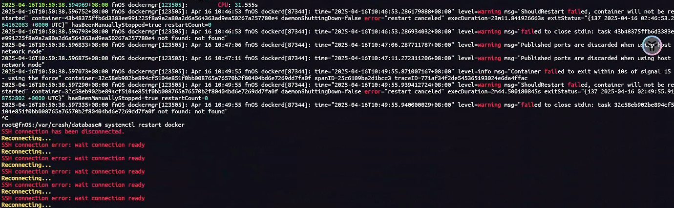

2025-4-16 10:52:56 楼主 显示全部楼层
重启docker时也出现了崩溃
