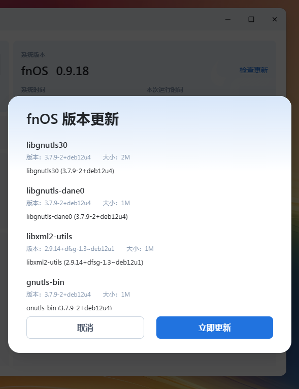

设备环境:物理机、局域网/公网、系统0.9.18,虚拟机安装ikuai做主路由
BUG现象:0.9.18更新失败,尝试按论坛教程手动安装也是失败

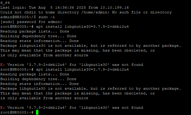

2025-8-6 17:27:17 显示全部楼层
先执行apt update再执行安装的命令试试
按提示执行 'apt --fix-broken install' 试试吗?  详情 回复

2025-8-6 19:38:15 楼主 显示全部楼层
root@NR5005:~# apt install libgnutls30=3.7.9-2+deb12u4
Reading package lists... Done
Building dependency tree... Done
Reading state information... Done
You might want to run 'apt --fix-broken install' to correct these.
The following packages have unmet dependencies:
libgnutls-dane0 : Depends: libgnutls30 (= 3.7.9-2+deb12u3) but 3.7.9-2+deb12u4 is to be installed
libpython3.11 : Depends: libpython3.11-stdlib (= 3.11.2-6+deb12u5) but 3.11.2-6+deb12u6 is to be installed
python3-setuptools : Depends: python3-pkg-resources (= 66.1.1-1) but 66.1.1-1+deb12u1 is to be installed
python3.11-minimal : Depends: libpython3.11-minimal (= 3.11.2-6+deb12u5) but 3.11.2-6+deb12u6 is to be installed
systemd : Depends: libsystemd-shared (= 252.30-1~deb12u2) but 252.38-1~deb12u1 is to be installed
           Depends: libsystemd0 (= 252.30-1~deb12u2)
systemd-container : Depends: libsystemd-shared (= 252.30-1~deb12u2) but 252.38-1~deb12u1 is to be installed
systemd-timesyncd : Depends: libsystemd-shared (= 252.30-1~deb12u2) but 252.38-1~deb12u1 is to be installed
E: Unmet dependencies. Try 'apt --fix-broken install' with no packages (or specify a solution).
root@NR5005:~#

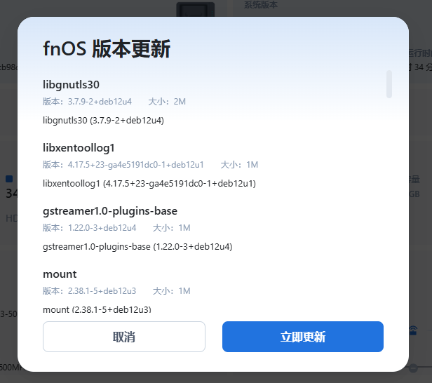

2025-8-7 10:04:56 显示全部楼层

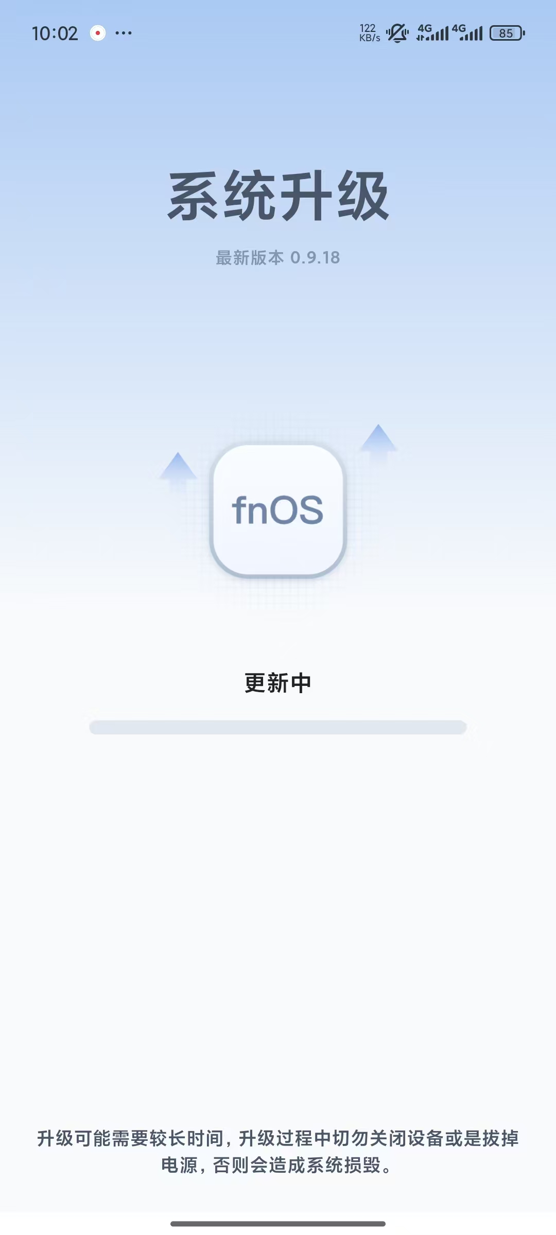

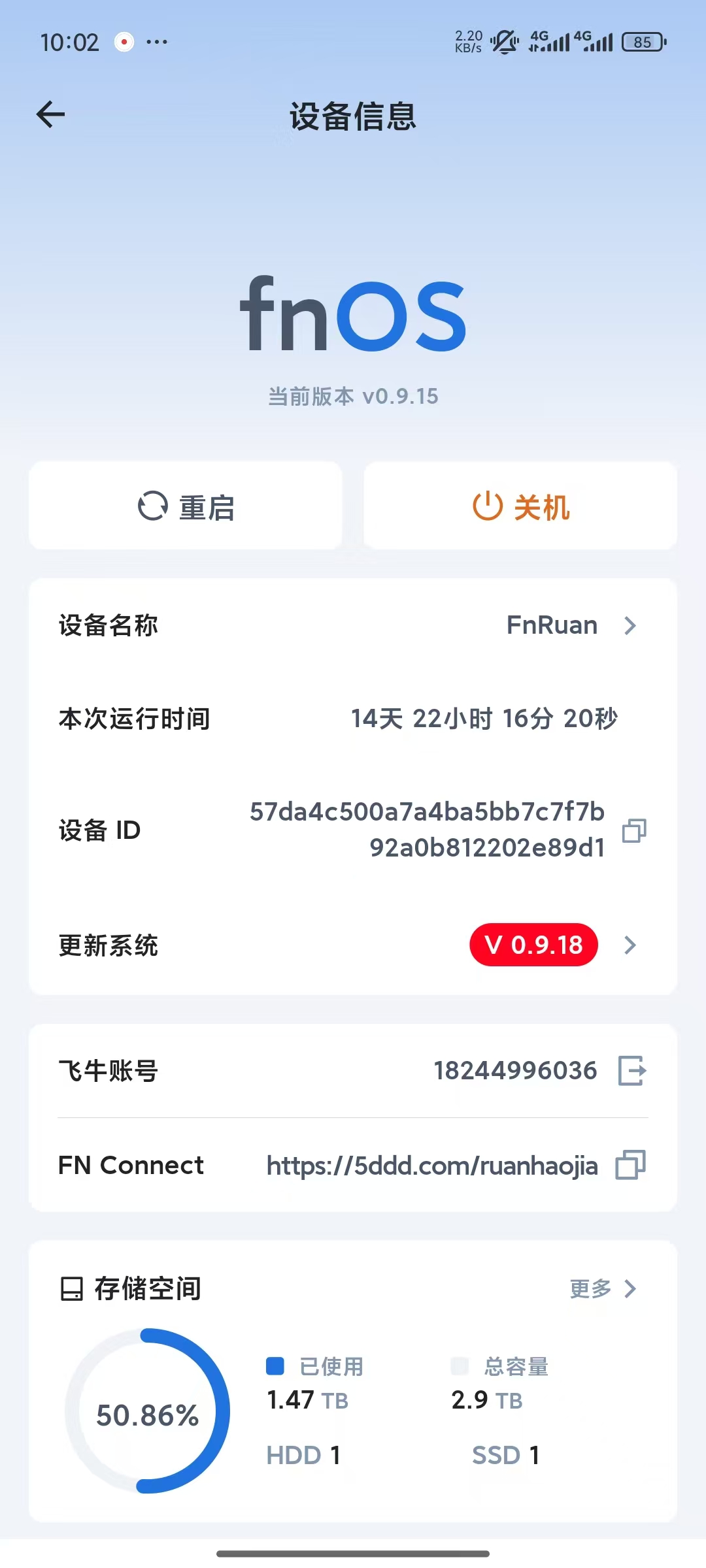

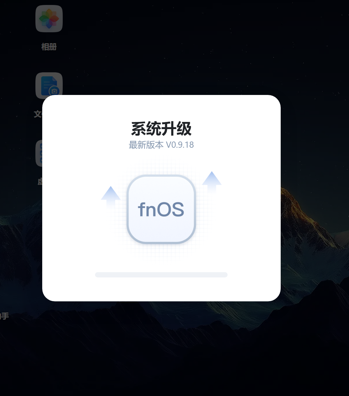

b62b7e009ea5f86c85e0724c28ac75fb.jpg更新进度卡了几天,APP功能还能正常使用,PC网页端登录后卡进度页面
2025-8-7 19:09:25 显示全部楼层

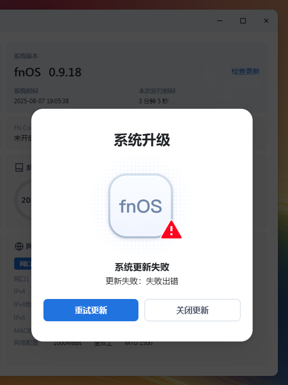

这个问题我也遇到,用虚拟测试后发现:如果在SSH终端执行了:apt upgrade -y 或 apt update -y 命令对系统进行了更新,100%出现前文问题。但我反复更新后,应用还是更新到0.9.18了,只是总提示有更新,立即更新时又出错,可能得重装系统,执行 'apt --fix-broken install' 也没用。
官方系统安装后,可能校验上有特殊要求,不能直接使用apt命令对Debian进行系统级更新,否则这个问题100%复现。
只能暂时无视更新了,等官方看看后续有没有方法修复。重装太麻烦了  详情 回复
2025-8-7 20:11
