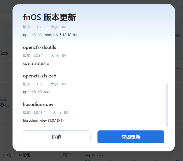

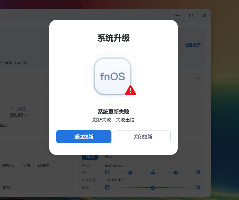

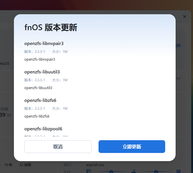

glmos-code-explain
设备环境:(物理机、局域网/公网、0.9.32)
BUG现象:(更新直接提示失败)
联系方式:(18510957998)
网络正常可ping
PING opencdncloudka.jomodns.com (117.187.39.35) 56(84) bytes of data.
64 bytes from 117.187.39.35: icmp_seq=1 ttl=57 time=3.39 ms
64 bytes from 117.187.39.35: icmp_seq=2 ttl=57 time=2.98 ms
64 bytes from 117.187.39.35: icmp_seq=3 ttl=57 time=3.70 ms
^C
--- opencdncloudka.jomodns.com ping statistics ---
3 packets transmitted, 3 received, 0% packet loss, time 2003ms
rtt min/avg/max/mdev = 2.978/3.354/3.695/0.293 ms
