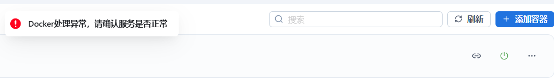

设备环境:物理机
BUG现象:docker内的容器挂载115网盘 启动不了 如下
我断开了与网盘的链接 重试依旧不行 使用1panel查看日志报错信息如下
Error response from daemon: failed to create task for container: failed to create shim task: OCI runtime create failed: runc create failed: unable to start container process: error during container init: error mounting "/vol02/1000-1-6f246bf2" to rootfs at "/115": create mountpoint for /115 mount: make mountpoint "/115": mkdirat /vol1/docker/overlay2/ccc722d8a006438d23788101bdc772b80066f6a47f0e10474a6c6c7c73163c7d/merged/115: operation not permitted: unknown 2025/11/22 14:01:50 [TASK-END]
测试 其他网盘挂载到容器没问题 我想知道是系统还是115的问题
