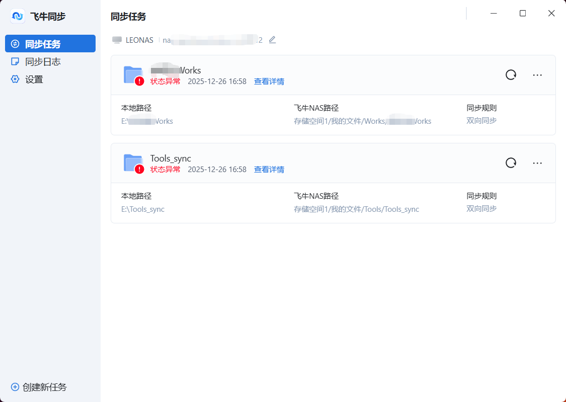

更新v0.1.5后无法连接反代地址
752
2025-12-26 17:17:16 显示全部楼层 阅读模式
设备环境:物理机、公网/反代/域名、系统:1.1.8、飞牛同步服务端0.17.0,客户端:v0.1.5
BUG现象:
1,更新v0.1.5后无法使用连接反代地址,能登录认证成功,但登录后都是状态异常。使用lucky反代https://192.168.11.2:5667,更新之前一直这样使用。
2,不用反代地址,直接开启路由器端口转发(也是自定义域名+自定义端口)能正常连接

2026-1-7 19:56:49 楼主 显示全部楼层
[2026-01-07][19:10:34][INFO][fn_sync_client_lib::tasks::init_task] 任务ID 1 双端文件对比完成,总耗时: 553.2441ms

[2026-01-07][19:22:23][INFO][fnsync_rs::transport::client] NasConOps: Host("nas.example.com", 54316, Some(())) Use ip type: RwLock { data: Host(CtUrl("nas.example.com", 54316, Some(())), Some([183.6.35.156:54316])) }
[2026-01-07][19:22:23][INFO][fnsync_rs::files::fnotify] NasEventListener::Start
[2026-01-07][19:22:23][INFO][fnsync_rs::files::fnotify] wsconnect
[2026-01-07][19:22:23][INFO][fnsync_rs::files::fnotify] open websocket: wss://nas.example.com:54316/sync/event/register with sessionid: 21b8dce0-a819-4ef0-9dc8-fb4676f3fb74
[2026-01-07][19:22:23][INFO][fnsync_rs::transport::sync_resolver] start resolve: Name("nas.example.com")
[2026-01-07][19:22:23][INFO][fnsync_rs::transport::sync_resolver] SyncResolver::resolve: nas.example.com -> [183.6.35.156:54316]
[2026-01-07][19:22:23][WARN][fnsync_rs::files::fnotify] ws connect failed: reqwest error, retry ...
[2026-01-07][19:22:26][INFO][fnsync_rs::transport::sync_resolver] start resolve: Name("nas.example.com")
[2026-01-07][19:22:26][INFO][fnsync_rs::transport::sync_resolver] SyncResolver::resolve: nas.example.com -> [183.6.35.156:54316]
[2026-01-07][19:22:26][WARN][fnsync_rs::files::fnotify] ws connect failed: reqwest error, retry ...
[2026-01-07][19:22:29][INFO][fnsync_rs::transport::sync_resolver] start resolve: Name("nas.example.com")
[2026-01-07][19:22:29][INFO][fnsync_rs::transport::sync_resolver] SyncResolver::resolve: nas.example.com -> [183.6.35.156:54316]
[2026-01-07][19:22:29][WARN][fnsync_rs::files::fnotify] ws connect failed: reqwest error, retry ...
[2026-01-07][19:22:32][INFO][fnsync_rs::transport::sync_resolver] start resolve: Name("nas.example.com")
[2026-01-07][19:22:33][INFO][fnsync_rs::transport::sync_resolver] SyncResolver::resolve: nas.example.com -> [183.6.35.156:54316]
[2026-01-07][19:22:33][WARN][fnsync_rs::files::fnotify] ws connect failed: reqwest error, retry ...

[2026-01-07][19:22:42][INFO][fnsync_rs::files::fnotify] wsconnect
[2026-01-07][19:22:42][INFO][fnsync_rs::files::fnotify] open websocket: wss://nas.example.com:54316/sync/event/register with sessionid: 6f03a3a9-8d86-4600-875a-d33b78aad51a
[2026-01-07][19:22:42][INFO][fnsync_rs::transport::sync_resolver] start resolve: Name("nas.example.com")
[2026-01-07][19:22:42][INFO][fnsync_rs::transport::sync_resolver] SyncResolver::resolve: nas.example.com -> [183.6.35.156:54316]
[2026-01-07][19:22:42][WARN][fnsync_rs::files::fnotify] ws connect failed: reqwest error, retry ...
[2026-01-07][19:22:45][INFO][fnsync_rs::transport::sync_resolver] start resolve: Name("nas.example.com")
[2026-01-07][19:22:45][INFO][fnsync_rs::transport::sync_resolver] SyncResolver::resolve: nas.example.com -> [183.6.35.156:54316]
[2026-01-07][19:22:45][WARN][fnsync_rs::files::fnotify] ws connect failed: reqwest error, retry ...
[2026-01-07][19:22:47][INFO][fn_sync_client_lib::tasks::renew] 开始重新加载任务 2
[2026-01-07][19:22:47][INFO][fn_sync_client_lib::tasks::init_task] 接收到任务退出信号,任务ID: 2
[2026-01-07][19:22:47][INFO][fn_sync_client_lib::tasks::tasks_manager] 任务ID 2 状态变为: Init
[2026-01-07][19:22:47][INFO][fn_sync_client_lib::tasks::init_task] 取消监控成功: E:\Works
[2026-01-07][19:22:47][INFO][fn_sync_client_lib::tasks::init_task] 清理任务ID 2 的通知器
[2026-01-07][19:22:47][INFO][fn_sync_client_lib::tasks::renew] 阶段1 2
[2026-01-07][19:22:47][INFO][watcher] 📛 [停止] 实例 watcher_1767784960772_93068724 收到停止信号
[2026-01-07][19:22:47][INFO][fn_sync_client_lib::connect::nas_client] 连接不存在,准备重连和登录...
[2026-01-07][19:22:47][INFO][fn_sync_client_lib::connect::nas_client] 开始创建新连接...
[2026-01-07][19:22:47][INFO][watcher] 已取消对路径的监控: E:\Works
[2026-01-07][19:22:47][INFO][watcher] 🧹 [Drop] 清理 FileSystemWatcher 实例: watcher_1767784960772_93068724
[2026-01-07][19:22:48][INFO][fnsync_rs::transport::sync_resolver] start resolve: Name("nas.example.com")
[2026-01-07][19:22:48][INFO][fnsync_rs::transport::sync_resolver] SyncResolver::resolve: nas.example.com -> [183.6.35.156:54316]
[2026-01-07][19:22:48][WARN][fnsync_rs::files::fnotify] ws connect failed: reqwest error, retry ...
[2026-01-07][19:22:51][INFO][fnsync_rs::transport::sync_resolver] start resolve: Name("nas.example.com")
[2026-01-07][19:22:52][INFO][fnsync_rs::transport::sync_resolver] SyncResolver::resolve: nas.example.com -> [183.6.35.156:54316]
[2026-01-07][19:22:52][WARN][fnsync_rs::files::fnotify] ws connect failed: reqwest error, retry ...
[2026-01-07][19:22:55][INFO][fnsync_rs::transport::sync_resolver] start resolve: Name("nas.example.com")
[2026-01-07][19:22:55][INFO][fnsync_rs::transport::sync_resolver] SyncResolver::resolve: nas.example.com -> [183.6.35.156:54316]
[2026-01-07][19:22:55][WARN][fnsync_rs::files::fnotify] ws connect failed: reqwest error, retry ...
[2026-01-07][19:22:58][INFO][fnsync_rs::transport::sync_resolver] start resolve: Name("nas.example.com")
[2026-01-07][19:22:58][INFO][fnsync_rs::transport::sync_resolver] SyncResolver::resolve: nas.example.com -> [183.6.35.156:54316]
[2026-01-07][19:22:58][WARN][fnsync_rs::files::fnotify] ws connect failed: reqwest error, retry ...
[2026-01-07][19:23:01][INFO][fnsync_rs::files::fnotify] drop NasEventListener
[2026-01-07][19:23:01][ERROR][fn_sync_client_lib::connect::nas_client] 创建SyncNasClient失败: Common error: failed to connect: wss://nas.example.com:54316/sync/event/register
[2026-01-07][19:23:01][ERROR][fn_sync_client_lib::connect::nas_client] 创建连接失败: Common error: failed to connect: wss://nas.example.com:54316/sync/event/register
[2026-01-07][19:23:01][ERROR][fn_sync_client_lib::tasks::renew] 获取NAS主机名失败 task_id: 1, 错误: Common error: failed to connect: wss://nas.example.com:54316/sync/event/register
[2026-01-07][19:23:01][INFO][fn_sync_client_lib::connect::nas_client] 创建新的SyncNasClient: host/nas.example.com:54316
[2026-01-07][19:23:01][INFO][fn_sync_client_lib::tasks::tasks_manager] 任务ID 1 状态变为: Failed
[2026-01-07][19:23:01][INFO][fn_sync_client_lib::connect::nas_client] 开始创建新连接...
[2026-01-07][19:23:01][ERROR][fn_sync_client_lib::tasks::tasks_manager] 重启任务 1 失败: Common error: failed to connect: wss://nas.example.com:54316/sync/event/register
[2026-01-07][19:23:01][INFO][fnsync_rs::transport::client] NasConOps: Host("nas.example.com", 54316, Some(())) Use ip type: RwLock { data: Host(CtUrl("nas.example.com", 54316, Some(())), Some([183.6.35.156:54316])) }
[2026-01-07][19:23:01][INFO][fnsync_rs::files::fnotify] NasEventListener::Start
[2026-01-07][19:23:01][INFO][fnsync_rs::files::fnotify] wsconnect
[2026-01-07][19:23:01][INFO][fnsync_rs::files::fnotify] open websocket: wss://nas.example.com:54316/sync/event/register with sessionid: 01b831f4-e992-4926-8c23-398e77929c1d
[2026-01-07][19:23:01][INFO][fnsync_rs::files::fnotify] open websocket: wss://nas.example.com:54316/sync/event/register with sessionid: db599352-cee7-4340-9d21-e58e42b39462
[2026-01-07][19:23:01][INFO][fnsync_rs::transport::sync_resolver] start resolve: Name("nas.example.com")
[2026-01-07][19:23:01][INFO][fnsync_rs::transport::sync_resolver] SyncResolver::resolve: nas.example.com -> [183.6.35.156:54316]
[2026-01-07][19:23:01][WARN][fnsync_rs::files::fnotify] ws connect failed: reqwest error, retry ...
[2026-01-07][19:23:04][INFO][fnsync_rs::transport::sync_resolver] start resolve: Name("nas.example.com")
[2026-01-07][19:23:04][INFO][fnsync_rs::transport::sync_resolver] SyncResolver::resolve: nas.example.com -> [183.6.35.156:54316]
[2026-01-07][19:23:04][WARN][fnsync_rs::files::fnotify] ws connect failed: reqwest error, retry ...
[2026-01-07][19:23:07][INFO][fnsync_rs::transport::sync_resolver] start resolve: Name("nas.example.com")
[2026-01-07][19:23:07][INFO][fnsync_rs::transport::sync_resolver] SyncResolver::resolve: nas.example.com -> [183.6.35.156:54316]
[2026-01-07][19:23:07][WARN][fnsync_rs::files::fnotify] ws connect failed: reqwest error, retry ...
[2026-01-07][19:23:08][INFO][fnsync_rs::transport::sync_resolver] SyncResolver::resolve: nas.example.com -> [183.6.35.156:54316]
[2026-01-07][19:23:08][WARN][fnsync_rs::files::fnotify] ws connect failed: reqwest error, retry ...
