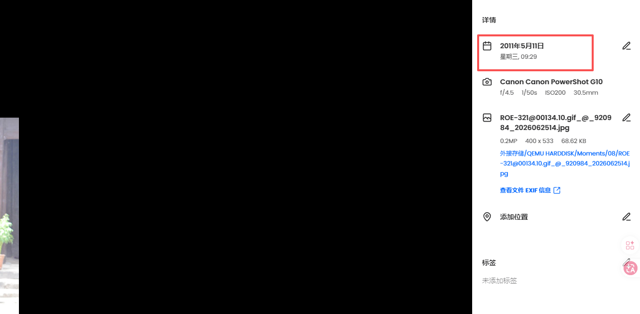

部分图片 文件管理器里的修改时间是日期a,相册里确被识别日期b,a的时间是对的b是错的,导致我好多图片放乱了,但是奇怪的是不是每个图片都是如此,只有小部分,见附件截图,并给出了它的exif,app端和web都是这样

exif
"Aperture": 4.5,
"ApertureValue": 4.5,
"BitsPerSample": 8,
"CircleOfConfusion": "0.006 mm",
"ColorComponents": 3,
"ColorSpace": "sRGB",
"ComponentsConfiguration": "Y, Cb, Cr, -",
"CompressedBitsPerPixel": 5,
"CreateDate": "2011:05:11 09:29:09",
"CustomRendered": "Normal",
"DateTimeOriginal": "2052-11-03 12:00:00",
"DigitalZoomRatio": 1,
"Directory": "/vol00/QEMU HARDDISK/Moments/08",
"EncodingProcess": "Baseline DCT, Huffman coding",
"ExifByteOrder": "Little-endian (Intel, II)",
"ExifImageHeight": 3456,
"ExifImageWidth": 2592,
"ExifToolVersion": 12.92,
"ExifVersion": "0221",
"ExposureCompensation": 0,
"ExposureMode": "Auto",
"ExposureTime": "1/50",
"FNumber": 4.5,
"FOV": "14.4 deg",
"FileAccessDate": "2052:11:03 12:00:00+08:00",
"FileInodeChangeDate": "2026:06:26 10:29:29+08:00",
"FileModifyDate": "2052:11:03 12:00:00+08:00",
"FileName": "ROE-321@00134.10.gif_@920984_2026062514.jpg",
"FilePermissions": "-rwxrwxrwx",
"FileSize": "70 kB",
"FileSource": "Digital Camera",
"FileType": "JPEG",
"FileTypeExtension": "jpg",
"Flash": "Off, Did not fire",
"FlashpixVersion": "0100",
"FocalLength": "30.5 mm",
"FocalLength35efl": "30.5 mm (35 mm equivalent: 142.3 mm)",
"FocalPlaneResolutionUnit": "inches",
"FocalPlaneXResolution": 11835.61644,
"FocalPlaneYResolution": 11835.61644,
"HyperfocalDistance": "32.11 m",
"ISO": 200,
"ImageDescription": " ",
"ImageHeight": 533,
"ImageSize": "400x533",
"ImageWidth": 400,
"LightValue": 9,
"MIMEType": "image/jpeg",
"Make": "Canon",
"MaxApertureValue": 4.5,
"Megapixels": 0.213,
"MeteringMode": "Multi-segment",
"Model": "Canon PowerShot G10",
"ModifyDate": "2011:05:11 09:29:09",
"RelatedImageHeight": 2592,
"RelatedImageWidth": 3456,
"ResolutionUnit": "inches",
"ScaleFactor35efl": 4.7,
"SceneCaptureType": "Standard",
"SensingMethod": "One-chip color area",
"ShutterSpeed": "1/50",
"ShutterSpeedValue": "1/50",
"Software": "www.meitu.com",
"SourceFile": "/vol00/QEMU HARDDISK/Moments/08/ROE-321@00134.10.gif
@_920984_2026062514.jpg",
"UserComment": "",
"WhiteBalance": "Auto",
"XResolution": 180,
"YCbCrPositioning": "Co-sited",
"YCbCrSubSampling": "YCbCr4:4:4 (1 1)",
"YResolution": 180

根据提供的EXIF 里 CreateDate 和 ModifyDate 都是 2011:05:11 09:29:09,相册显示的时间基本对应这两个字段。根据信息判断可能是图片修改/转存/编辑后部分 EXIF 时间字段被修改影响了,而相册通常会优先按图片元数据里的拍摄时间归档,所以出现了你认为的识别不一致。

2026-7-6 21:35:31 楼主 显示全部楼层
飞牛技术同学 发表于 2026-7-1 15:43
根据提供的EXIF 里 CreateDate 和 ModifyDate 都是 2011:05:11 09:29:09,相册显示的时间基本对应这两个字 ...
麻烦看下具体的取值的逻辑是什么 优先取CreateDate 和 ModifyDate 没有的话取什么时间
2026-7-6 21:37:00 楼主 显示全部楼层
拍摄时间具体取的是哪个时间
2026-7-6 22:45:23 楼主 显示全部楼层
按照exif的规范你们应该取 DateTimeOriginal  群晖就是这样的
